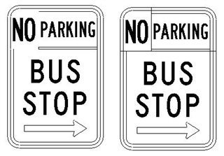

Question:
How can I display the panel edge lines between panels in a multi-panel sign in OpenRoads SignCAD?
Answer:
It is useful to toggle panel missing edges ON:
  • To see the panel edge lines between different colored panels when using outline mode.
  • Before selecting a multi-panel sign to cut in the SignCAM>Cut Selected.
  • Before copy/pasting signs into MicroStation or OpenRoads Designer in monochrome or without fill color.
  • Before exporting signs to DWG/DXF in monochrome or without fill color.
1. Pick Preferences>Drawing.
2. In the Drawing dialog under the Multi-panel section, press the Toggle panel missing edges button ON to show the panel edge lines between the panels.
