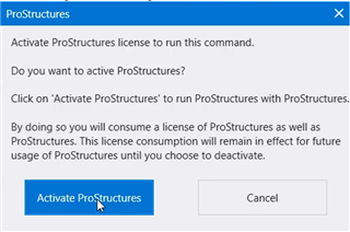

In OpenBuildings Designer, the following message appears when using certain steel building features.
Which functions are affected?
A paid license usage does not apply to the use of the standard toolboxes, e.g. "Place steel column" or "Place steel beam".
Only functions via key-in are affected, e.g. the command "prosteel create extendedtruss".
This message appears once.
If "Activate ProStructures" has been selected, a chargeable ProStructures license is used.

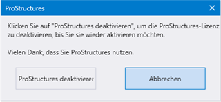

To terminate the license usage, enter the key-in psmain license select.
Then the following message appears:
The key-in psmain change license enables the use of the ProStructures license again.
