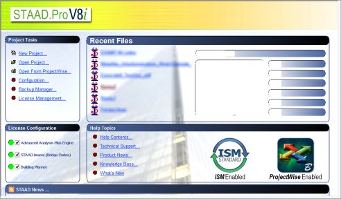

STAAD.Pro V8i SS5 and later
The Bentley Trust Licensing schema was introduced in the V8i SS5 release of STAAD.Pro. STAAD.Pro and key add on capabilities such as Advanced Analysis Plus, STAAD.Beava and Building Planner should be activated by clicking on icons on the License Configuration of the Start Page when STAAD.Pro is launched.  If these options have not previously been activated, the activation wizard will be launched and allow the options to be set if available in the SELECT server site.
Design code usage is logged and does not require pre-selection as was required in earlier versions described below.  However, if a design code is used that requires a license that has not previously been activated on the local machine, then this will display the activation wizard for authentication.
To view the licenses that are available and their current status, click on the License Management icon in the Project Tasks section of the Start Page.
