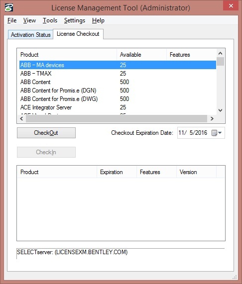

In the case of a node-locked license, the user will enter the server name "productactivation.bentley.com" and the activation key provided by Bentley. The user will then have to check out the license from the server using the License Management Tool before opening the product. If this is not done, the program will run in demonstration mode and the user will not be able to compute or save model files.
For network licenses, once a license has been obtained, the program will be fully operational at the purchased feature level and will not need to communicate with the server for another 30 days. In other words, a SELECTserver product needs to be able to communicate with the server at least once every 30 days.
Additional information on using the License Management Tool is provided in the sections that follow.

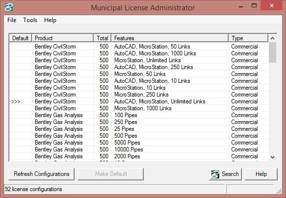

The Hydraulics and Hydrology product licensing and activation information can be viewed and configured using the Municipal License Administrator and License Management Tool. Both of these tools are installed during the installation of the SELECTserver-compatible product and can be accessed through the Windows start menu. (Start > All Programs > Bentley > Product Name > Select Tool).
The License Management Tool is a useful aid for managing checked out or disconnected licenses. It displays the list of available license configurations and allows checking out, checking in, and importing licenses. The products listed depend on what your organization has licensed from Bentley. The License Checkout tab contains the product name, features, and the number of available licenses.
The Municipal License Administrator is useful for managing default license configurations for products with multiple possible feature configurations. For example, if your organization has a license of WaterCAD for up to 250 pipes, and another license of WaterCAD for 5,000 pipes, this tool allows you to choose the default license used by the individual client machine. The default license configuration can be changed at any time with this tool, for instance due to different project requirements. If you have entered your server and activation code, but the don't see any licenses listed, try clicking "Refresh Configurations". The column labeled "Total" shows the number of licenses for a given product. The column labeled "Features" shows the size of the license, as well as any other features, such as AutoCAD integration.
