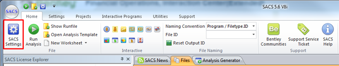

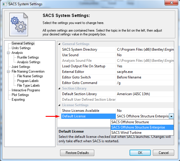

Configure Default License setting
If SACS is used with checked out licenses, ensure that the product is configured to use the correct package license on startup by performing the following steps:
  1. Click the Home tab.
  2. Click the SACS Settings button.
  3. In the window that appears, locate the Default License setting on the right pane, and ensure that it is configured for the package license checked out on the machine.
  4. Click the OK button to save any changes.
