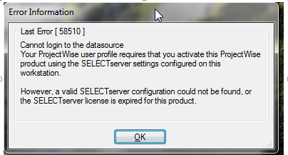

The 58510 Error
The message you are getting indicates that ProjectWise Explorer is not licensed correctly, or is unable to obtain a license.
If your account doesn’t own any licenses for ProjectWise Explorer Client (Bentley CONNECTIONS Passport / BIM Review Visa / ProjectWise Design Integration Visa) and you are required to "Bring your own" license (your user account on the ProjectWise Server you are connecting to is configured as " Activate and record usage through client's configured SELECTserver") you will get this message.
For versions prior to ProjectWise Explorer Client SES (Version:10.00.03.434) you can verify the activation status from the License Management Tool. There is not a shortcut to the License Management Tool for these versions of Projectwise Client, but you can run the executable from Windows explorer, the location of the license management tool is -
C:/Program Files (x86)/Bentley/Projectwise/Bin , file is named “licensetool.exe”
Instructions for activating against the Bentley hosted licensing are here -
Activating Against SELECTserver OnLine (a Bentley hosted server)
http://communities.bentley.com/products/licensing/w/licensing__wiki/4987.aspx
 If you are getting this message just recently, there may have been a change to the ProjectWise Server that you are connecting to, now requiring you to have your own license for ProjectWise Explorer (instead of supplying you with a license that is paid for by the owner of the ProjectWise Server). You may wish to check with the owner to see if anything has changed.
