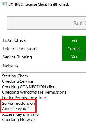

To confirm whether server mode is enabled, conduct the following steps:
  1. Open CONNECTION Client.
  2. Select "Health Check" from the drop-down menu in the upper right.
  3. Run the Health Check tests, and note as highlighted below whether Server Mode is on and the Access Key is blank.
    Screenshot of Health Check window
