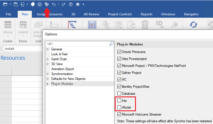

When SYNCHRO Pro is installed, two modules are enabled by default that use licenses in addition to SYNCHRO Pro. Depending on the licenses available, unexpected licensing notifications may appear when opening the program. To examine and optionally disable the use of licenses other than SYNCHRO Pro, please perform the following steps.
  1. Open SYNCHRO Pro.
  2. Click the Settings drop-down menu along the top edge.
  3. In the Options window that appears, select Plug-in Modules along the left edge.
  4. Note the Iray and iModel options which utilize additional licenses:
    1. Iray - When enabled, logs usage against the SYNCHRO Pro - Iray Add-On license
    2. iModel - When enabled, logs usage against the SYNCHRO 4D Pro license
  5. Click the OK button to save changes, and restart SYNCHRO Pro to apply the new license configuration.
Screenshot of SYNCHRO licensing options
