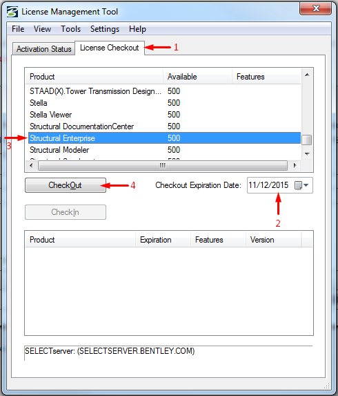

  1. Open the License Management Tool.
  2. Select the License Checkout tab.
  3. Modify the Checkout Expiration Date value if necessary.
  4. Then select the Structural Enterprise license in the top pane.
  5. Click the CheckOut button.

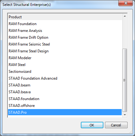

  6. A list of products covered by the Structural Enterprise license will appear. Choose one or more products, and click the OK button.

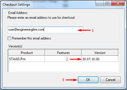

  7. Then enter an email address and version number (if not already pre-filled), and click the OK button.
