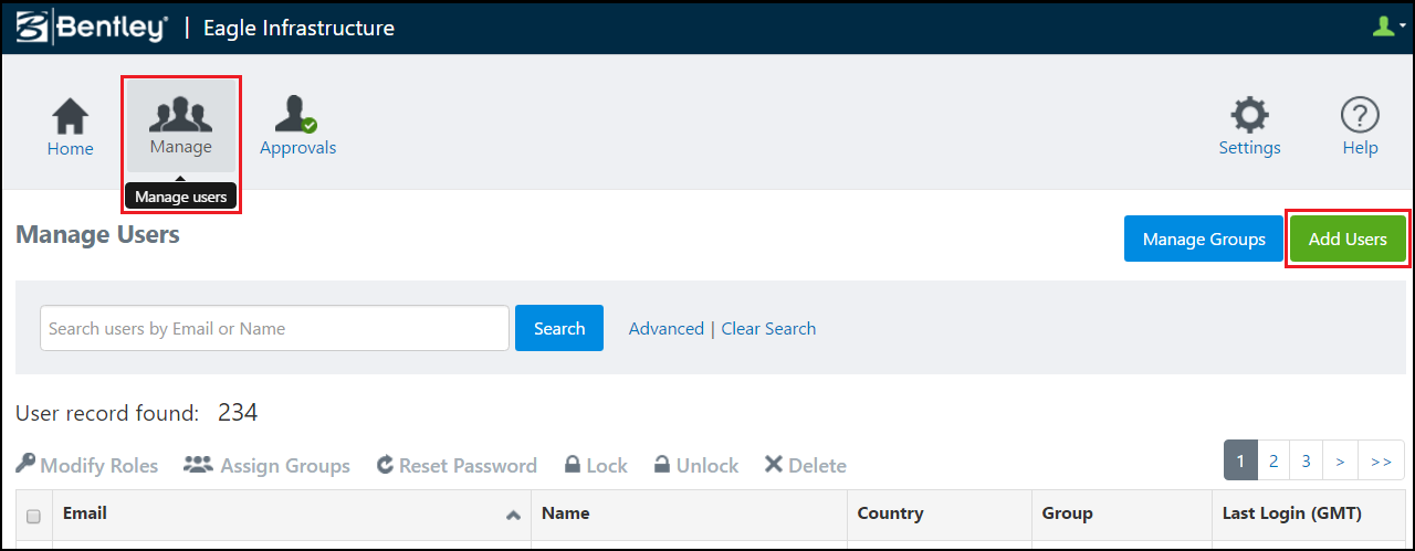

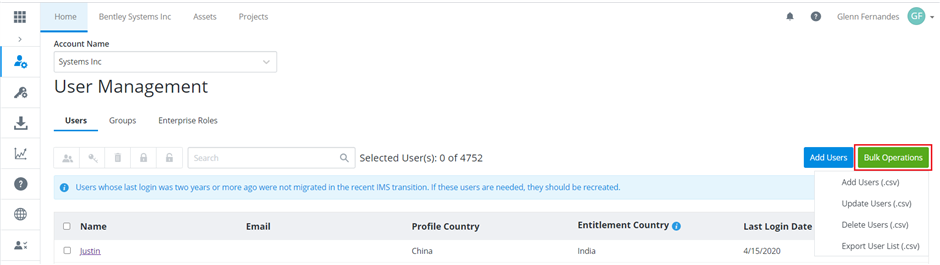

1. Click Bulk Operations
2. Select Add Users (.csv)

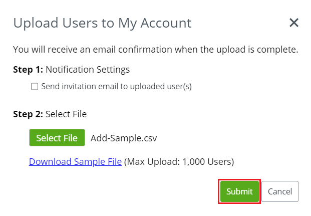

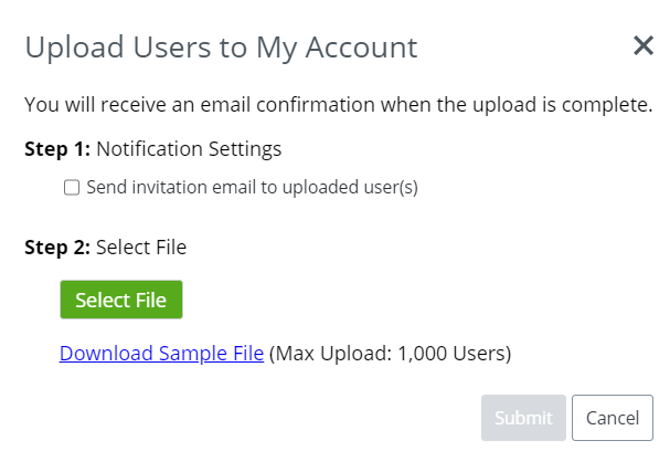

3.  Click Download Sample file or use the Select file option to import your .csv file
4.  Click Submit to import the list of users
5. Welcome emails will automatically be sent to the new CONNECTED Users if 'Send invitation email to uploaded user(s) is toggled on.

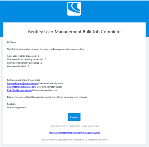

6. Once the job is completed, an email will be sent to the Account Administrator.

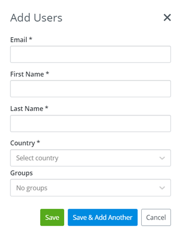

*Please note: To add users Individually, select Add Users and enter the email, first name, last name, and country of the user.  Complete the process by clicking the Save button.
2. Select Update Users
