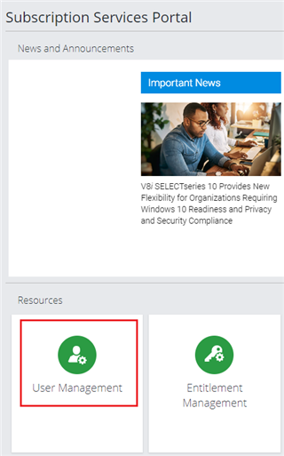

  1. Open the Subscription Services Portal.
  2. Locate the Resources section, and click on the User Management tile.
    OR
    Navigate to User Management
    Screenshot with User Management tile highlighted

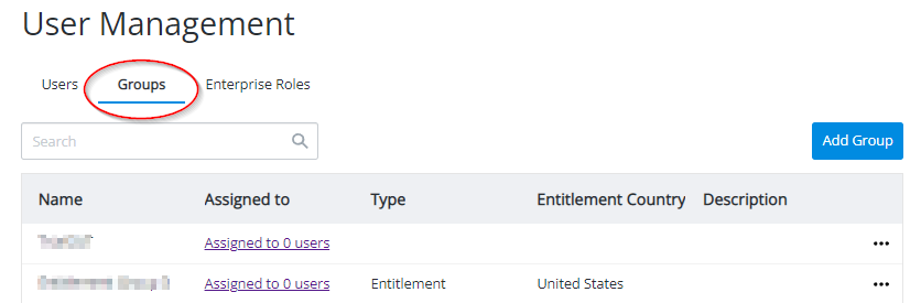

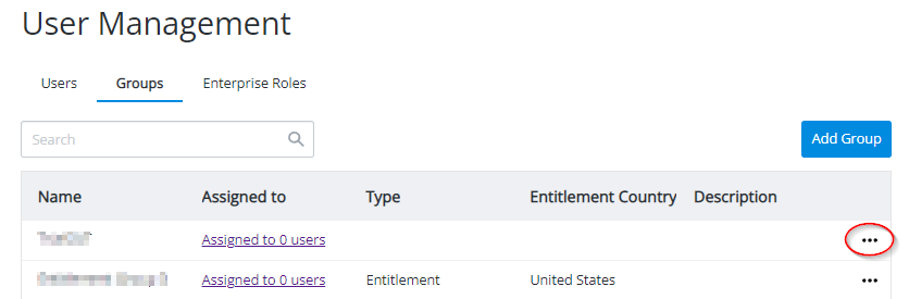

  3. Select the Groups tab under Organization users and roles.

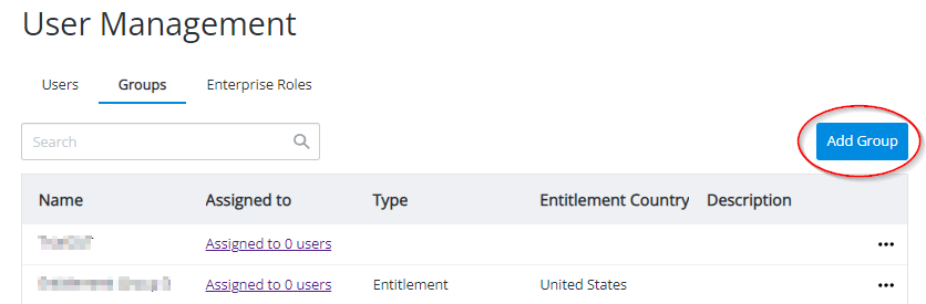

  4. Click the blue Add Group button in the upper right.

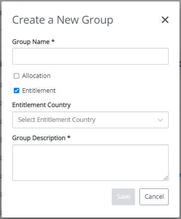

  5. In the window that appears, create a new group by giving your group a name and selecting Entitlement as the appropriate group type.
  6. Also open the Entitlement Country drop-down menu, and choose a country.
  7. Enter a group description if desired, and click the Save button.

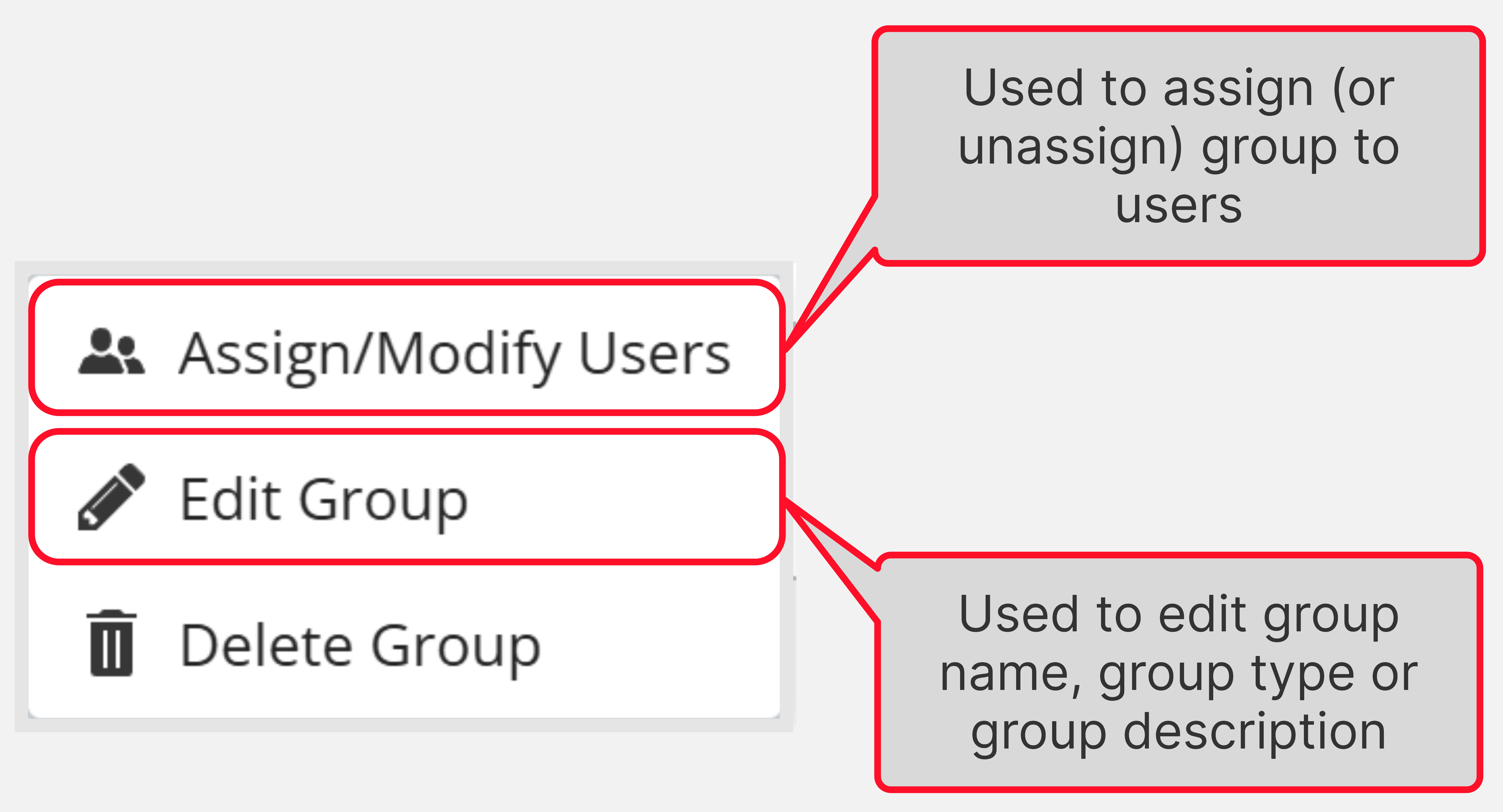

  8. Your Entitlement Group will display in the list with a total of zero (0) users. Click the "..." link to assign users.
The following will appear -

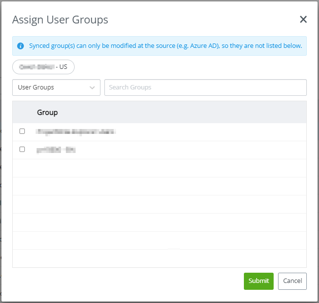

Choosing "Assign Group" will bring up the following -

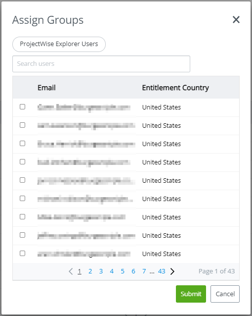

You can search for individual users, or go page by page and check off the users you wish to assign. After all the users you wish to add to the group have been selected, click "Submit". If this is an existing group with users already assigned, they will already be checked off. You can remove them from the group by unchecking their box and hitting "Submit".

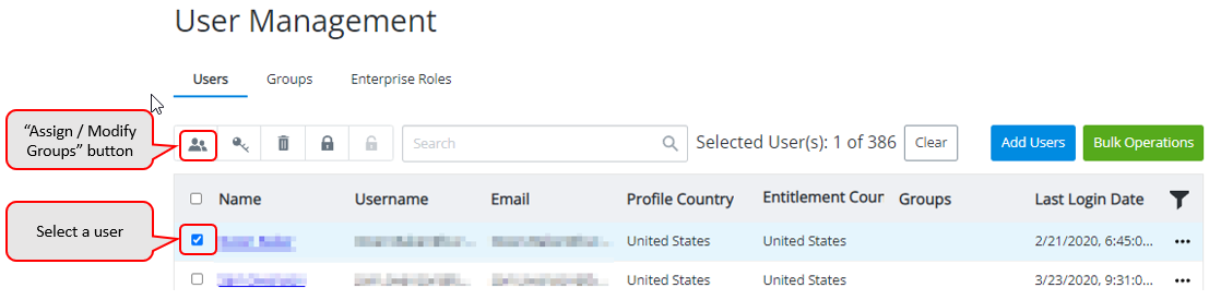

You can also add or delete a user (or users) from groups by selecting a user, and then clicking on the "Assign / Modify Groups" button.
You will get the following screen with a list of groups that are available to assign the user to, note that you have to select the correct group type from the dropdown (User Groups, Allocation Groups, or Entitlement Groups") -
