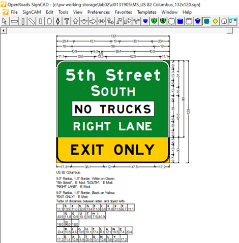

How do I open an OpenRoads SignCAD SGN file inside ProjectWise?

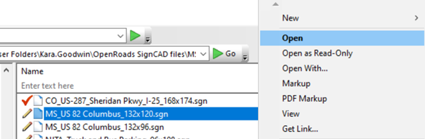

1) In ProjectWise Explorer, right click on the SGN file and pick Open.

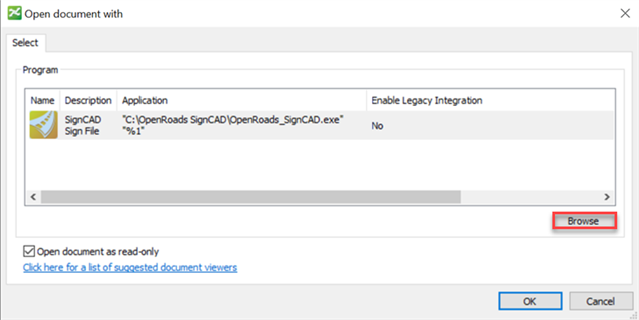

2) In the Open document with dialog, the C:\OpenRoads SignCAD\OpenRoads_SignCAD.exe path should be listed under Program as shown below. Press OK to open the selected SGN file in OpenRoads SignCAD. NOTE: If OpenRoads SignCAD is not listed in the Open document with dialog, then follow the steps below.

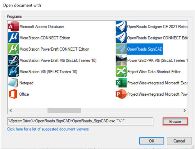

a) In the Open document with dialog, pick the Browse button. Select the OpenRoads SignCAD program and press OK to both Open document with dialogs. If OpenRoads SignCAD is not listed, then pick the Browse button.

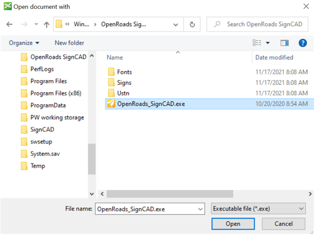

b) Browse to the C:\OpenRoads SignCAD folder and select the OpenRoads_SignCAD.exe and press Open.
c) Select OpenRoads SignCAD from the Open Document with dialog and press OK. OpenRoads SignCAD with the path should now be listed in the other Open Document with dialog. Press OK to open the selected SGN file in OpenRoads SignCAD.
