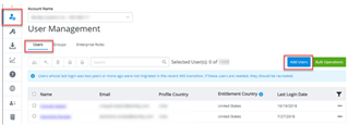

1. On the Users and Groups screen, click the Users tab and then click the Add Users button in the upper right corner.
2. Complete the fields and click the Save button.

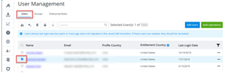

3. On the User Management screen, click the Users tab and then select the user.

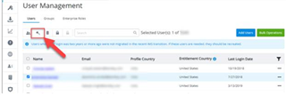

4. Click the Assign Roles icon on the screen above the user list.
5. Select Co-Administrator role from the list and click the Submit button.
