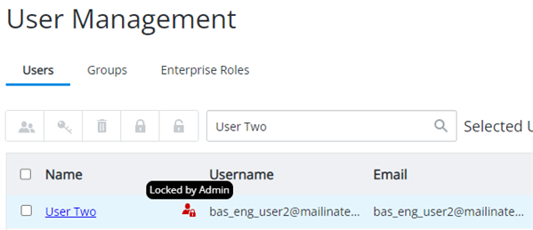

  3. Search for the locked user account, and confirm whether the account is still locked. If locked, it should display a padlock icon. Hovering over the icon will reveal why the account is locked.
    Screenshot of locked user icon

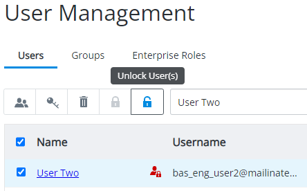

  4. Select the checkbox to the left of the user account, and click the Unlock button above the list.
    Screenshot of Unlock User(s) icon
