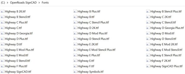

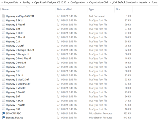

The Highway and SignCAD font files (ttf) as well as the SignCAD font resource files (Signcad_plus.rsc and SIGNCAD.rsc) are provided with the following Bentley applications:
NOTE: A valid license of at least one of the applications listed below is required on all machines that use these fonts.
OpenRoads SignCAD
OpenRoads Designer
OpenRail Designer
OpenRail Overhead Line Designer
OpenBridge Designer
OpenSite Designer

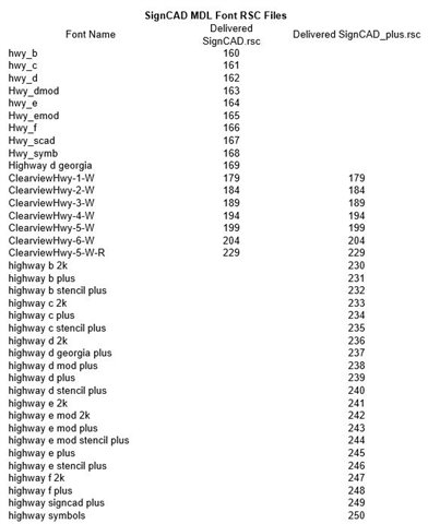

Here is a list of the font translation numbers used in the delivered SignCAD RSC files.

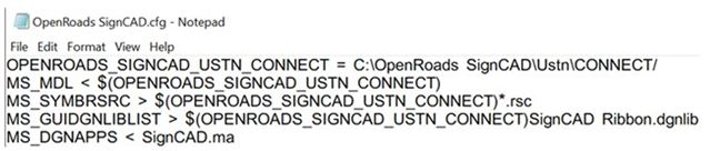

NOTE: If the SignCAD workflow does not display after loading the SignCAD MDL, then open the OpenRoads SignCAD.cfg file located in the OpenRoads Designer appl folder in Notepad.
If the MS_GUIDGNLIBLIST > $(OPENROADS_SIGNCAD_USTN_CONNECT)SignCAD Ribbon.dgnlib line is commented out (has a # before the line), then remove the # before the line and save your changes.
Your OpenRoads SignCAD.cfg should look like the one shown below:
