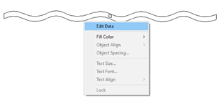

1) In OpenRoads SignCAD, right click on the graphic and pick Edit Data.

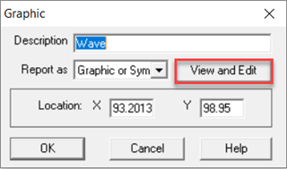

2) In the Graphic dialog box, press the View and Edit button.

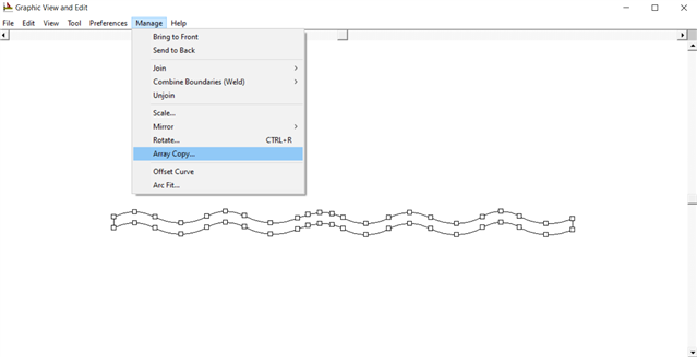

3) In the Graphic View and Edit window, select the graphic and pick Manage>Array Copy.

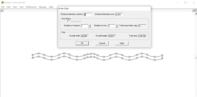

4) In the Array Copy dialog, set the desired Distance between column and rows. In this example, the Distance between columns = 1 and Distance between rows = 0.025. Use Number of columns =1 and Number of rows = 3 to get a total of 3 waves with an overall height = 4.5”. Press OK.

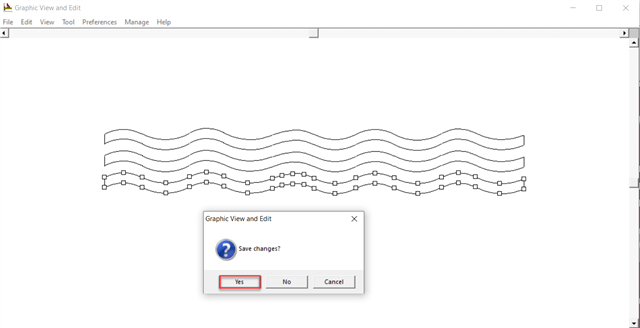

7) Pick File>Close and "Yes" to save changes.

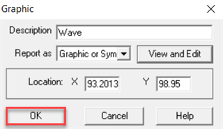

8) In the Graphic dialog box, press OK.
9) Save the file (File>Save or File>Save As).
