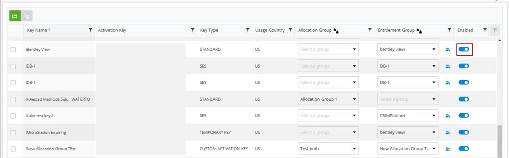

Disable Activation Keys
To disable an Activation Key, click the slider at the far-right of the row in the Enabled column.

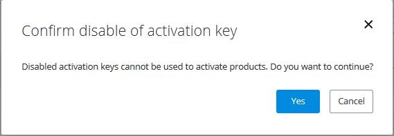

When you click this slider, you will receive a pop-up confirming you wish to disable the Key. Click Yes to disable the Key.
The slider will turn gray. Click it again to re-enable the Key.

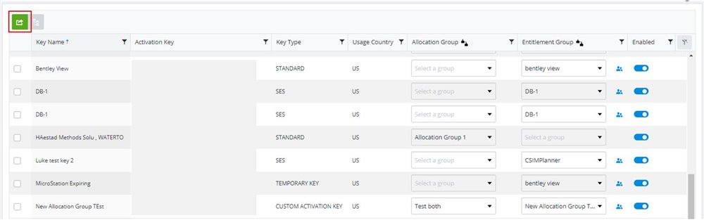

Export Activation Key Mappings
To export the entire grid to Excel, click the green Export to Excel button near the top left of the grid.
