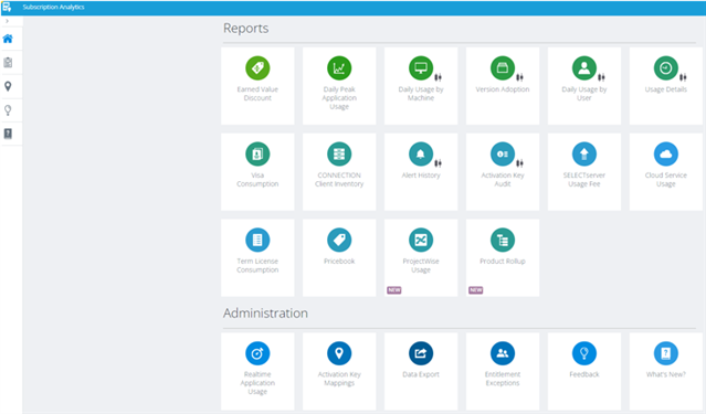

Access
  1. Go to the Subscription Analytics
  2. Click on the ProjectWise Usage report

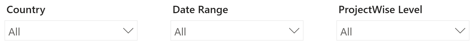

Filters
Name
Description
Country
User's Entitlement Country
Date Range
3-month time periods. Visa processing starts on the 10th of the first month in the period therefore a new interval is added on the 11th day in that interval.
ProjectWise Level
Name of the ProjectWise Level

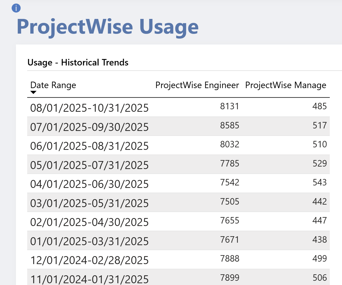

Layout - Usage - Historical Trends
Number of each ProjectWise Level that was consumed. This table is not impacted by any filters and shows your account's entire ProjectWise Level consumption history beginning May 1, 2019. The Dates are sorted in descending order so the most recent is always at the top. Below the list is a line graph with the same information.
Name
Description
Date Ranges
Reset Period.
ProjectWise Level
Name of the ProjectWise Levels that were used.

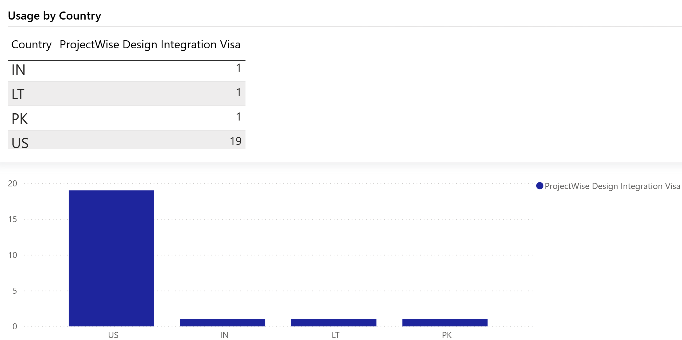

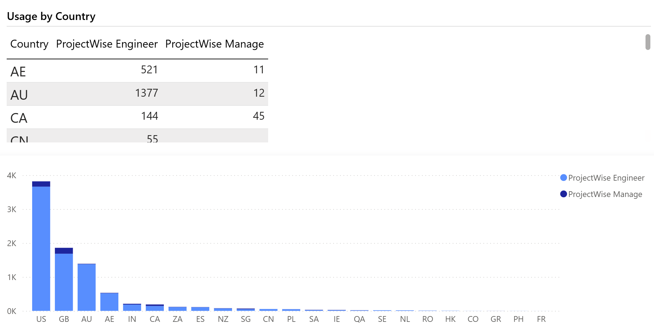

Layout - Usage by Country
Number of each type of ProjectWise Level that was consumed in each Country with a Totals row across the top. You must select a Date Range for this table to appear.
Name
Description
Country
ProjectWise Level

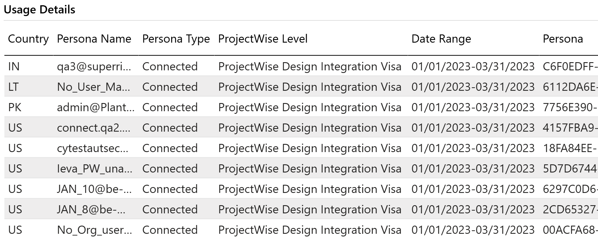

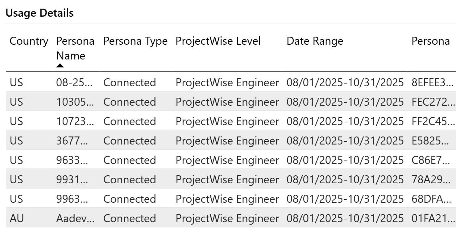

Layout - Usage Details
The ProjectWise Level report uses the concept of a Unique Persona.
Name
Description
Country
Persona Name
The Windows NT User name (if Not Connected) or the IMS user's email address (if Connected).
Persona Type
Indicates if the Persona is Connected or Not Connected.
ProjectWise Level
Name of the ProjectWise Level.
Date Range
Reset Period.
Persona
The Unique ID used for the Persona.

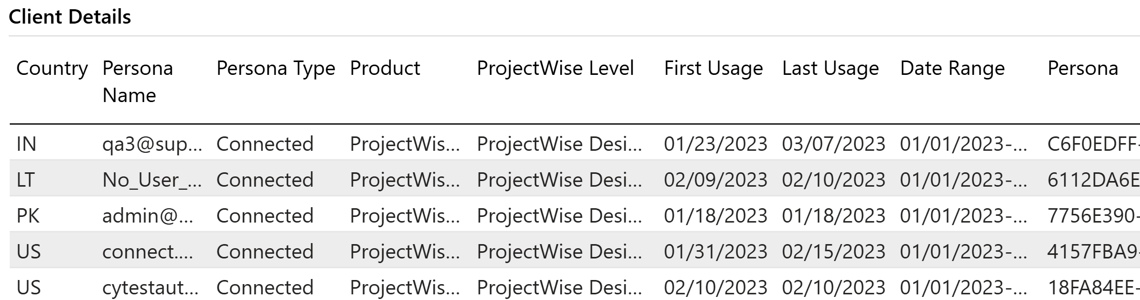

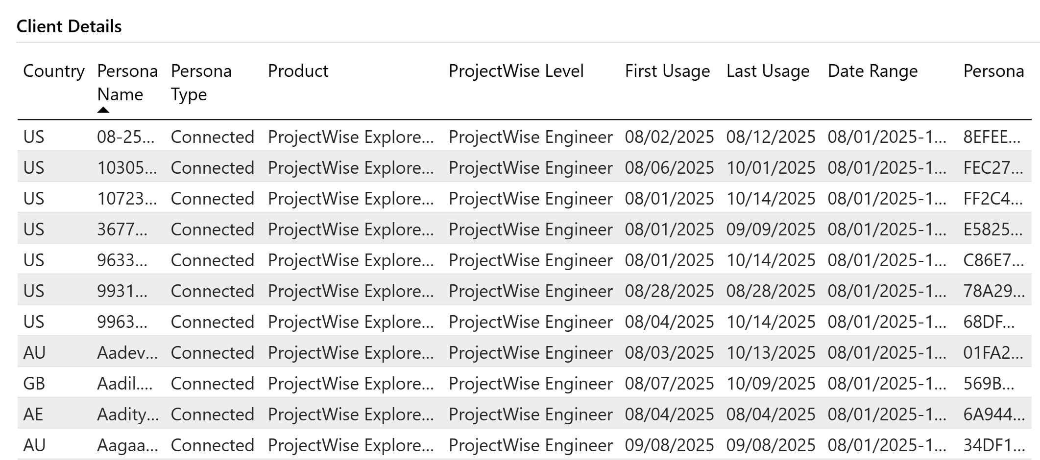

 Layout - Client Details
The Client details will show specifically which applications were used in the quarter that triggered a ProjectWise Level Consumption.
Name
Description
Country
Persona Name
Persona Type
Product
The product whose use triggered a ProjectWise Level consumption.
ProjectWise Level
First Usage
The first time that product was used by that persona in the quarter.
Last Usage
The last time that product was used by that persona in the quarter.
Date Range
Reset Period.
Persona
