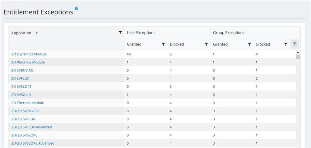

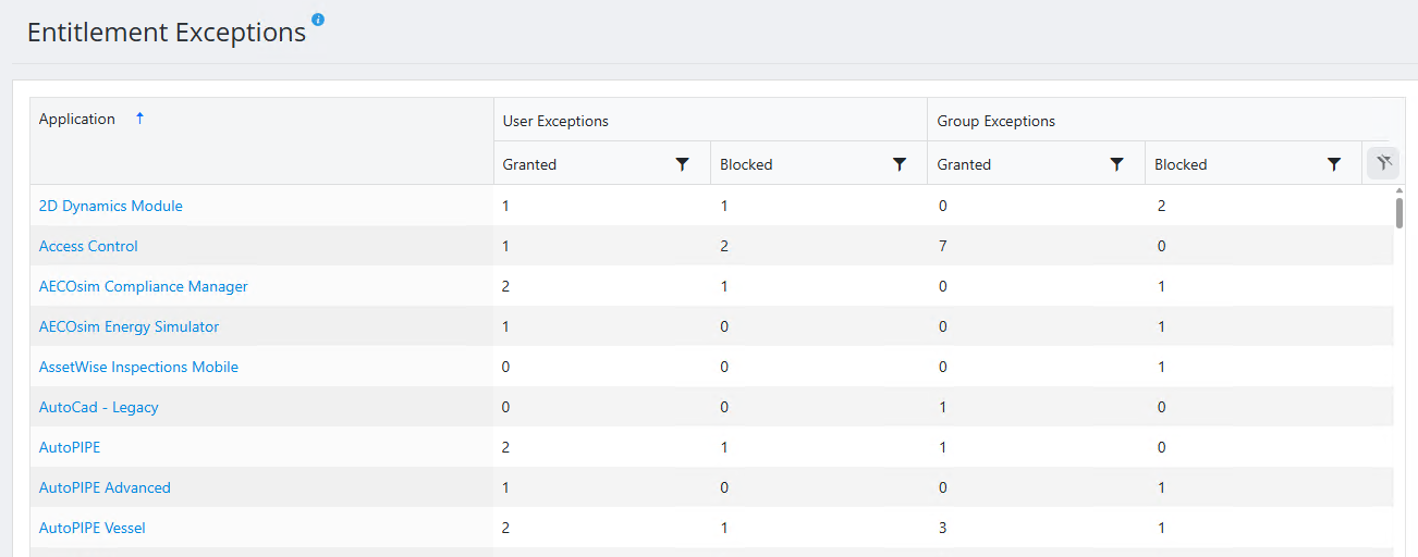

A summary of the number of User Exceptions and Group Exceptions that have been given for each Product across all Entitlement Countries. Click on any column header to sort the grid by values in that column. Click on the Product name to view a detailed list of the Exceptions for that Product.
Name
Description
Product
Product and Feature String
User Exceptions - Granted
The number of individual users that have been given a Granted Exception to the product. This does not count users that are in an Entitlement Group that has been Granted.
User Exceptions - Blocked
The number of individual users that have been given a Blocked Exception to the product. This does not count users that are in an Entitlement Group that has been Blocked.
Group Exceptions - Granted
The number of Entitlement Groups that have been given a Granted Exception to the product.
Group Exceptions - Blocked
The number of Entitlement Groups that have been given a Blocked Exception to the product.

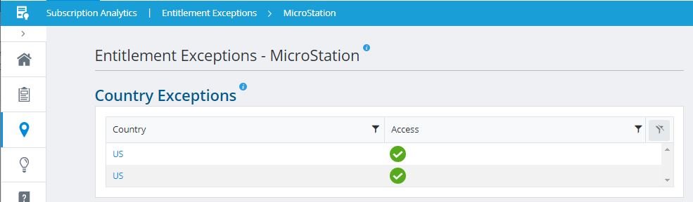

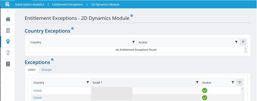

This page may be accessed by clicking the Product name in the landing page. It lists the details of the Exceptions for a specific Product. To return to the original landing page, click on the Entitlement Exceptions text in the blue header.
Layout - Country Exceptions
If an Entitlement Country has an Exception, it will be listed here. Click on the Country name to go directly to Entitlement Management.

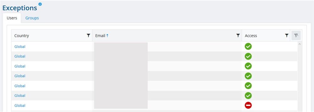

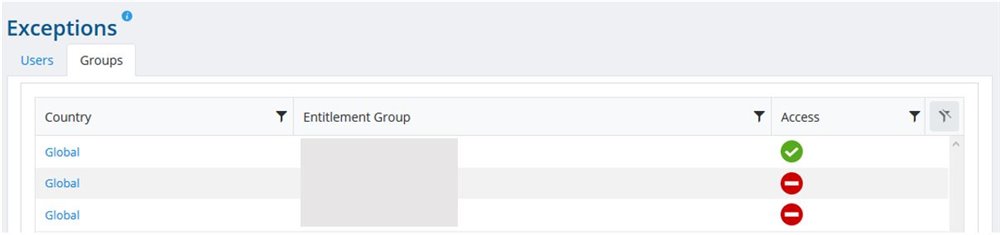

Layout - Exceptions
There is a grid for both Users and Entitlement Groups. If either a User or Group have been given an Exception, they will be listed here with their Email (for Users) and Entitlement Group (for Groups). Users that inherit an Exception from their Entitlement Group are not listed underneath the Users tab unless they have been given an explicit Exception in addition to what they inherited from the Group. Click on the Country name to go directly to Entitlement Management.
