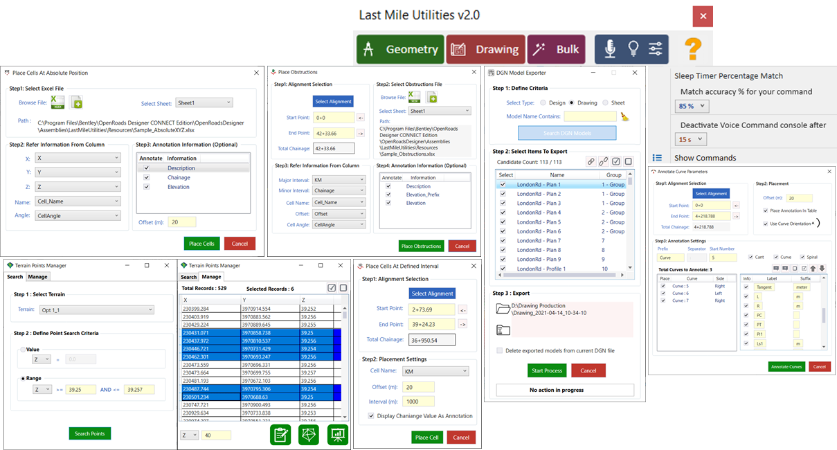

LastMileUtilties v2.0
What are LastMileUtilities?

How to Install LastMileUtilities App & Use?
Tool Key-in
Sr. No. Tool Description
Key In command
1 LastMile Open Opens Last Mile Utilities toolbar LM Open
2 LastMile Close Closes Last Mile Utilities toolbar LM Close
3 LastMile Help Shows Help for Last Mile utilities toolbar LM Help
4 Place Obstructions Place Cells using an alignment using obstuctions data mentioned in the Excel file LM Place Cells_From_Excel
5 Place Cells at Defined Intervals Place Cells at a defined interval along with an alignment Location LM Place Cells_At_Interval
6 Place Cells At Absolute Position Place Cells at Absolute Location using the data mentioned in the Excel file LM Place Cells_At_Absolute_Position
7 Annotate Curve Parameters Annotate Curve Parameters LM Annotate Curve
8 Terrain Points Manager Update Terrain Point(X, Y, or Z), Exports Terrain Points report LM Show Terrain_Points_Manager
9 DGN Models Exporter Group All CrossSections ina  Single DGN, Split All Sheets Into Individual DGN, or Split DGN Libraries LM Show DGN_Model_Exporter
10 VoiceCommand Start Starts Voice Command Console LM VoiceCommand Start
11 VoiceCommand Stop Stops Voice Command Console LM VoiceCommand Stop
12 VoiceCommand List Shows a list of voice commands and allows the user to add, edit, or delete commands
LM VoiceCommand List
13 Level Display Manager Apply the Level Display settings from the Current DGN to all selected DGN
LM Show Level_Display_Manager
14 Side Slope Annotation Annotate slope lines between 2 selected features/lines (2D or 3D) with customizable placement options (tech preview) LM Annotate Slope
