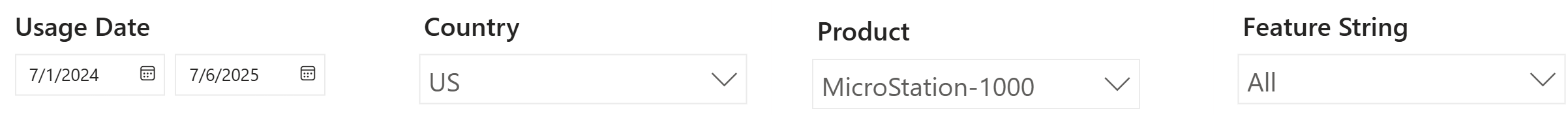

Filters
For an accurate analysis of your peak application usage, the Country, Product, and Feature String (where applicable) filters should all be used.
Name
Description
Usage Date
Custom date range. The default selection of Date is the past 365 days.
Country
User's Entitlement Country
Product
Product with ProductID
Feature String
Feature String

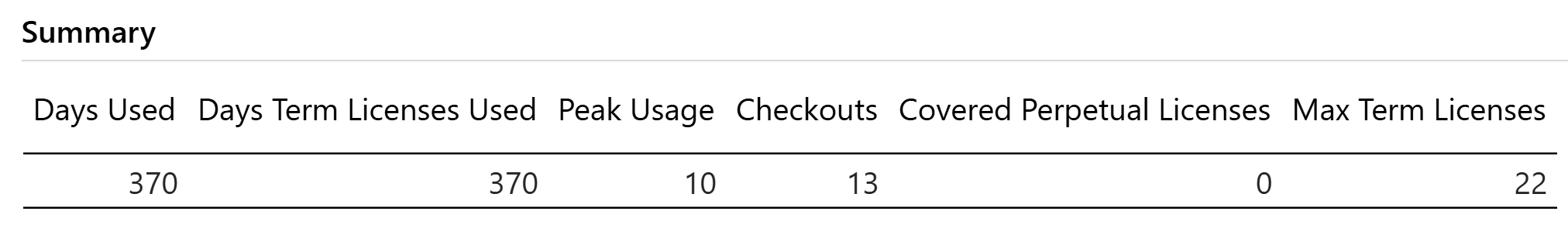

Layout - Summary
This is some overall information about your Peaks.
Name
Description
Days Used
Number of days the product was used at least once
Days Term Licenses Used
Number of days there was at least one term license used
Peak Usage
The highest peak in the time frame
Checkouts
Number of usages that were checkouts
Covered Perpetual Licenses
Number of licenses that are part of the contract today
Max Term Licenses
Largest number of term licenses that would be consumed according to the number of covered licenses today

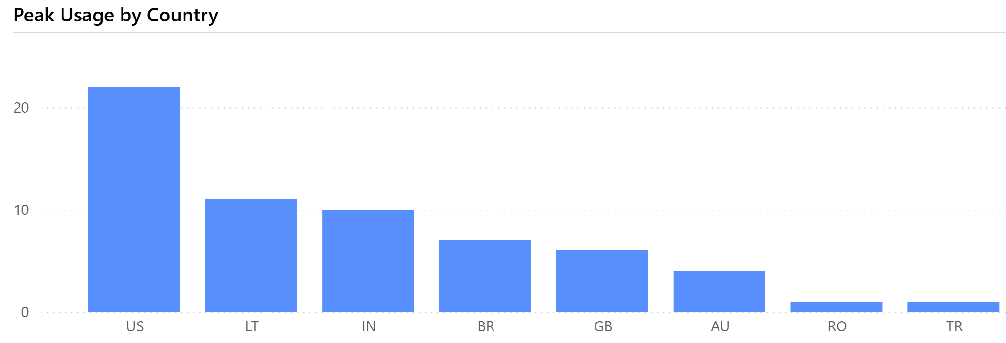

Layout - Peak Usage by Country
It shows the Sum of Checkouts and Standard Usage by Entitlement Country.

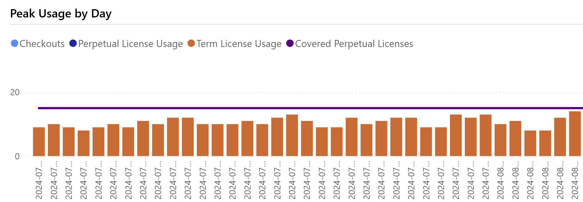

Layout - Peak Usage by Day
Name
Description
Day
Usage Date
Checkouts
Number of usages that were Checkouts
Perpetual License Usage
Number of usages that were neither term licenses or Checkouts
Term License Usage
Number of term licenses that would be consumed according to the number of covered licenses today
Covered Licenses
Indicates the number of covered licenses today

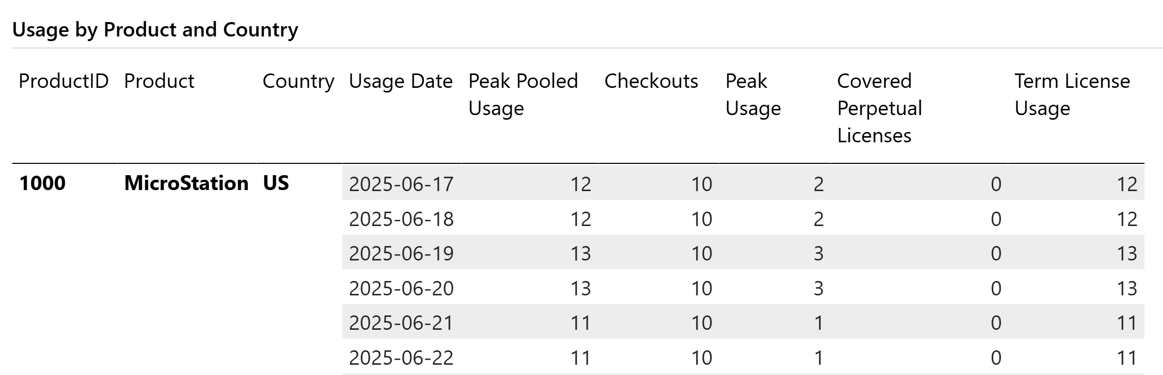

Layout - Usage by Product and Country
Name
Description
ProductID
Product ID
Product
Product and Feature String
Country
Entitlement Country
Usage Date
Usage Date
Peak Pooled Usage
Sum of Checkouts, Term Licenses, and Perpetual Licenses
Checkouts
Number of checkouts
Peak Usage
Sum of Term and Perpetual Licenses
Number of covered licenses today
Term License Usage
