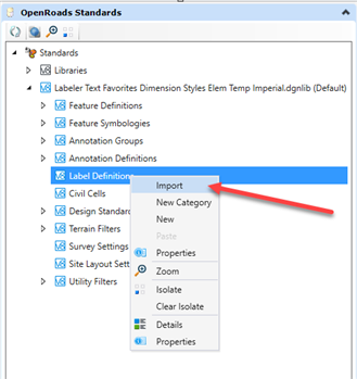

  1. Ensure this variable is set _CIVIL_STANDARDS_IMPORTEXPORT = 1
  2. Open the Explorer>OpenRoads Standards>Label Definitions, then right click and select import
