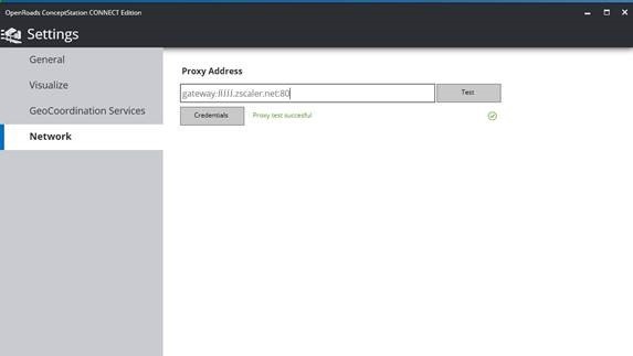

How do I set up ConceptStation to access map and geocoordination sites through a proxy server?
Product(s):OpenRoads ConceptStation
Version(s):10.00.03.15
Area: ConceptStation
Question:
Answer:
After launching ConceptStation, go to the backstage menu and select Settings>Network, then enter the proxy server information.  Click Test.

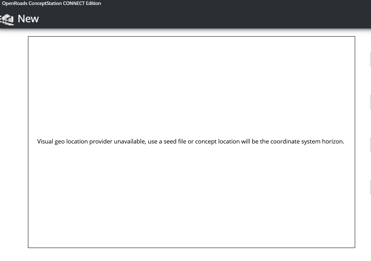

The map display also requires system proxy settings to be correctly set.
