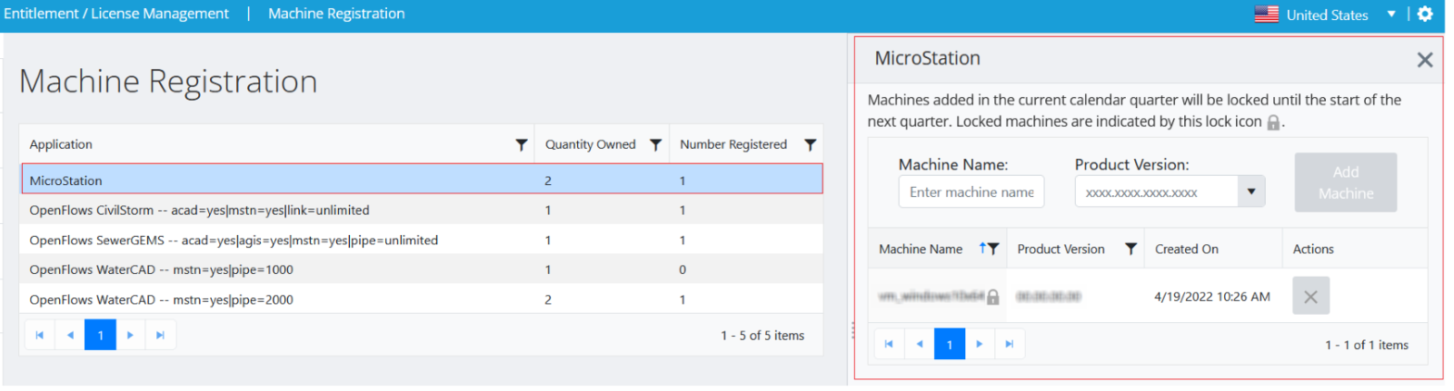

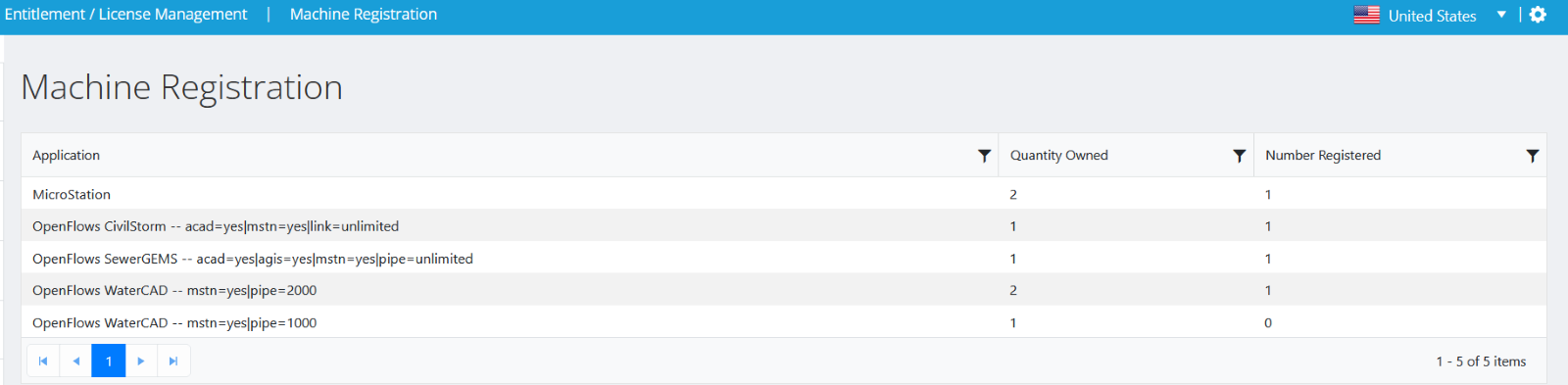

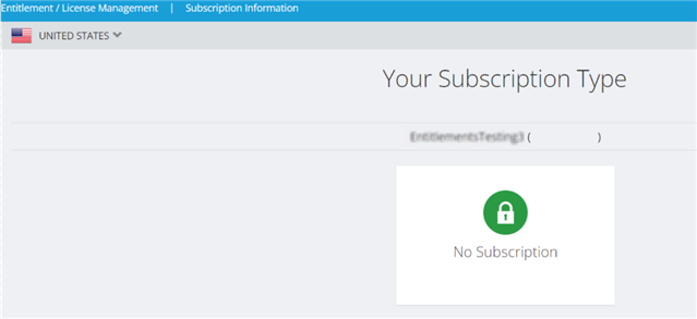

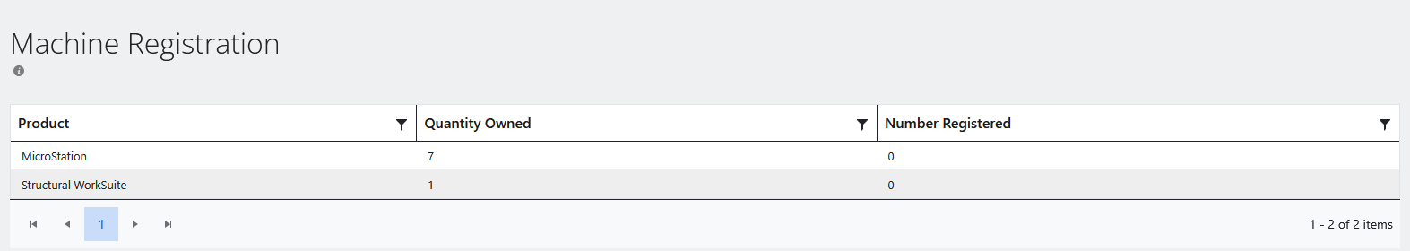

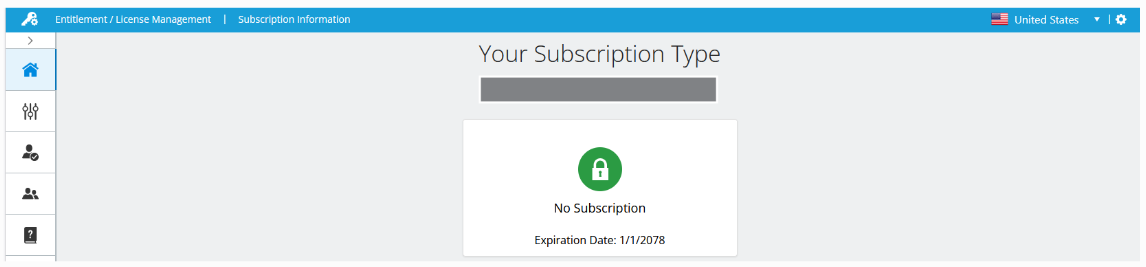

Log in to Entitlement Management portal  as organization administrator and click the “No Subscription” tile to go to the Machine Registration list

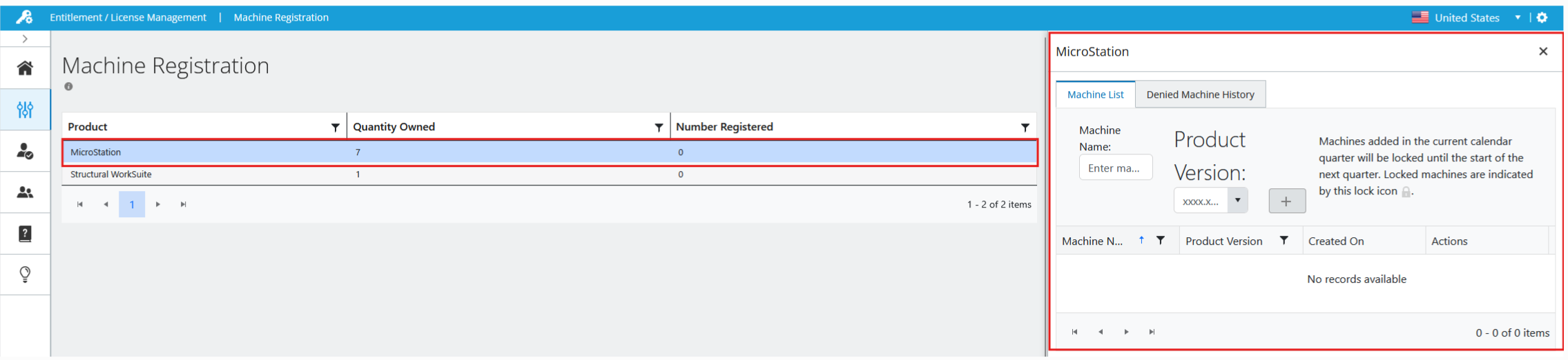

Here you can see the list of the products with respective number of the licenses of each product that the organization owns and the number of machines registered for each product.

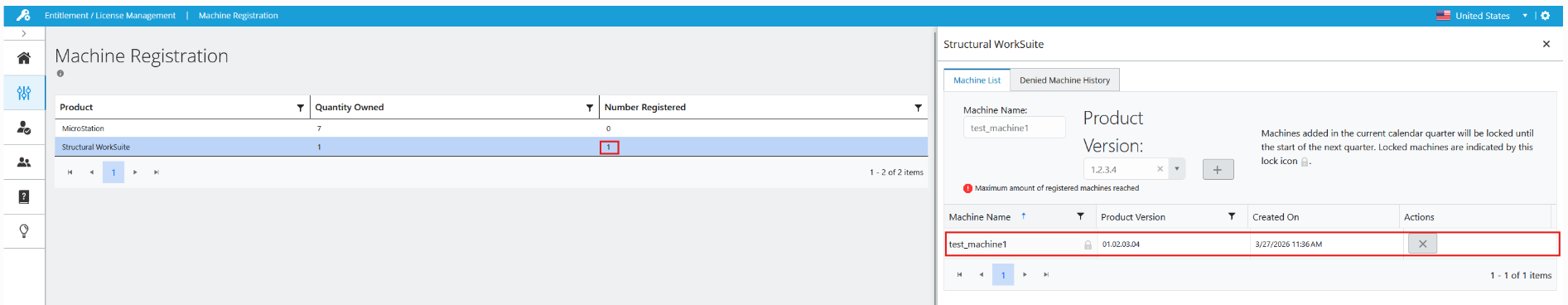

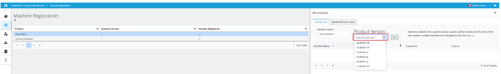

To manage the list of registered machines for a product, click on the product name.

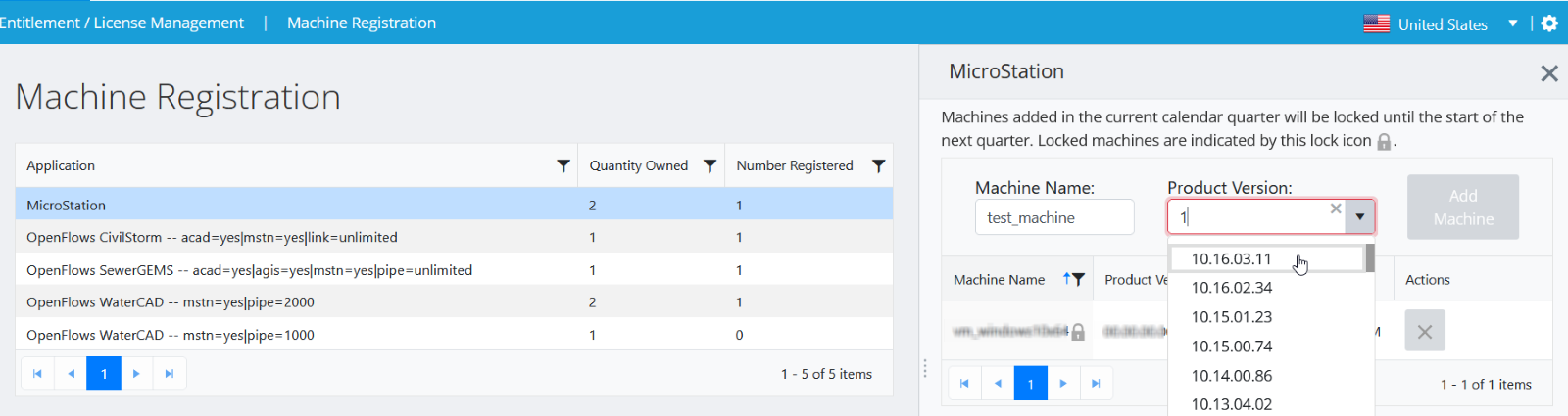

Fill in the accurate machine name and accurate product version - if the product is already installed, you can check its version in Windows Control Panel > Programs > Programs and Features in the 'Version' column:

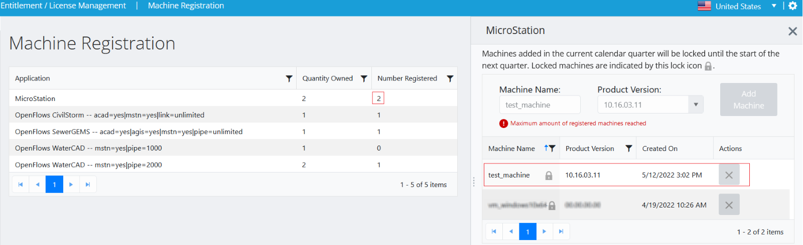

Click the “Add Machine” button:

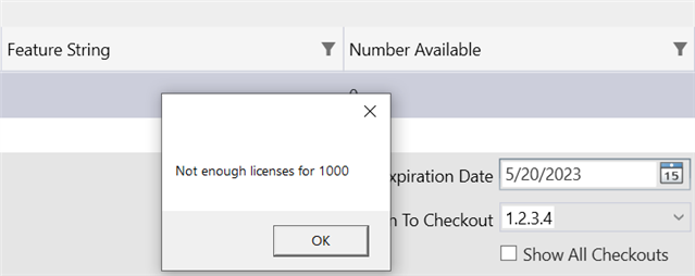

Machine is added to the list, “Number Registered”  is getting updated. If maximum amount of registered machines is reached, you will get a notification (in red) in side section:

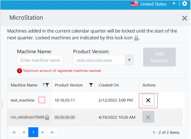

Machine registered will be locked until the end date of the calendar-quarter that the registration occurred. Once it gets unlocked, the “Lock” icon next to the machine name will be gone, and “Delete machine” action will become available.

How to remove a registered machine?
Go to the Machine Registration list and click a respective product. Check that the machine you want to remove does not have the Lock icon and the “Delete machine” button is enabled. Click the “Delete machine” button – machine gets removed from the list.

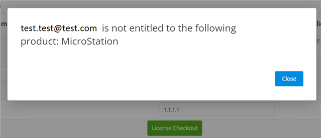

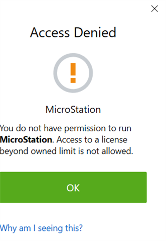

What will the user see if their machine is not in the list?
You will get an “access denied” messages while trying to do a checkout (in Entitlement Management Portal or in License Client) or trying to launch a product. Please see examples of the messages below (where product is Microstation).
  1. License checkout:
2. Launching a product:
