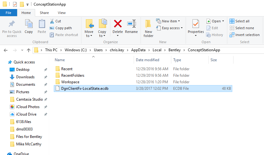

Answer for version 10.0.13.36:
Before beginning, make a backup copy of your .3sm file. The workaround is to download/install the DB browser for SQLite and edit the GCS text.
Launch the DB browser for SQLite
Go to File > Open database and open the .3sm file
Go to the Browse Data tab
See the red arrows in the screen capture below
  1. Change to view the Table SMMasterHeader
  2. Click on the GCS column text
  3. On the left, replace the text as below
    1. From
      VERT_CS["Generic Geoid",VERT_DATUM["Generic Vertical Datum",2005]
      To
      VERT_CS["Ellipsoid Height",VERT_DATUM["Ellipsoid",2002]
  4. Click Apply.
  5. File > Save All. Close program.
  6. Reopen the DgnDb with ConceptStation and verify that the elevation of the 3sm is corrected.
