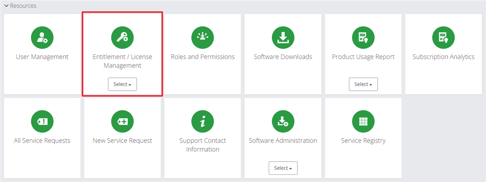

  1. Access the Entitlement/License Management portal:

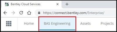

    • Navigate to the CONNECT Center.
    • Select the icon with your account name.
      CONNECT Center - your company name
    • Select the "Entitlement/License Management" tile from the Resources section.
      Entitlements/License Management tile in Resources section

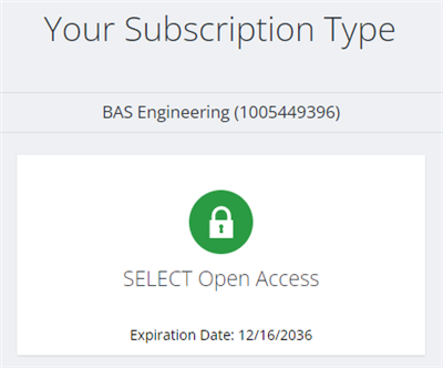

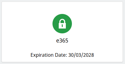

  2. On the home page of the Entitlement/License Management page, click the tile that corresponds to your current subscription - it can be, for example: SELECT, SELECT Open Access, e365 (for enterprise subscriptions).
    Your Subscription Type tile
    NOTES:

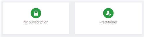

    - If you do not have an active subscription (e.g. SELECT Open Access, e365), you will see a "No Subscription" tile and clicking it will not show any licensing portfolio. Instead, it will move you to the Machine Registration page, on which you will see your licences (node locks) and their machine assignments.
    For more information, see: non-SELECT Announcement and FAQs and Machine Registration for non-SELECT accounts.
    - The Expiration Date includes a 60-day grace period, which is added to the actual contract expiration date. This allows you to use the purchased licenses in a situation where you did not renew the contract before its expiration date. For E365 contracts, an additional two years are added to the contract end date.
    Date format used for the Expiration Date is: MM/DD/YY - month/day/year, e.g. 03/26/2022.

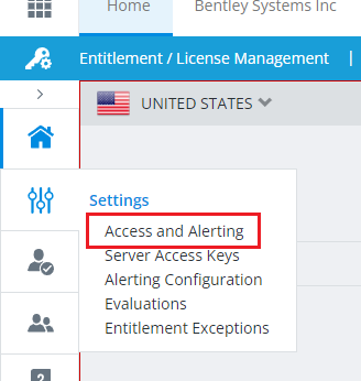

  3. An alternative way of accessing the licensing portfolio is from the side navigation - select Settings > Access and Alerting:
    Selecting Access and Alerting from the side navigation
  4. If your account has an enterprise agreement/subscription, the Entitlement/License Management page will show an "e365" tile and the "Global" entitlements:
The licences/entitlements will always be listed in the "Global" entitlements and will always show "Unlimited" quantity. The page will also show additional entitlement countries in the Entitlements drop-down button, usually at least the country in which you purchased the licenses. Your account can also have multiple other entitlement countries.
Your account will either list no licences for specific entitlement countries, or will list only some specific licenses. Those were usually not included in the enterprise agreement (and not showing in the "Global" entitlements) and were purchased specifically to be used in the corresponding entitlement country.

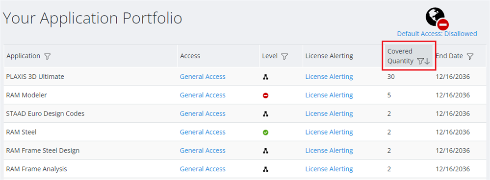

  1. If you purchased Practitioner Licenses from Bentley's eStore, you will also see a "Practitioner" tile. To check the number of Practitioner licenses, you will need to click that tile.
    Subscription Type and Practitioner tiles
  2. A table with applications will appear. Click the "Covered Quantity" header text to sort the list by covered quantity. When sorting in descending order (arrow points down), all the applications you purchased will be listed one below each other.
    Sort Cover Quantity in descending order
  3. The number in the "Covered Quantity" column represents the number of licensees you purchased.
