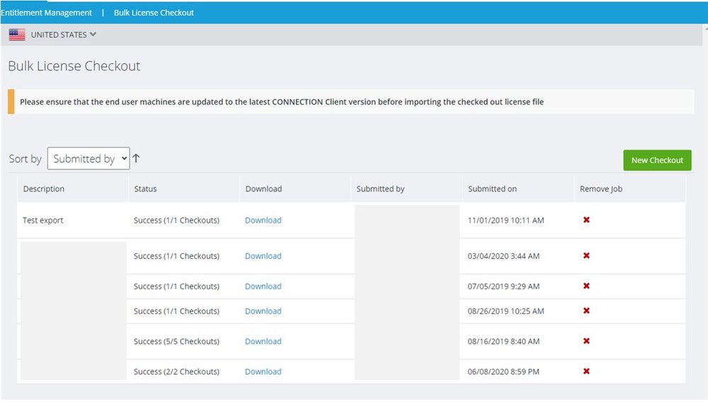

https://connect-entitlementmanagement.bentley.com/entitlement/license_bulkcheckout
2. On the Bulk License Checkout page, click the green New Checkout button at the top right of the page.

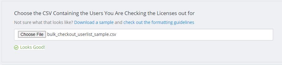

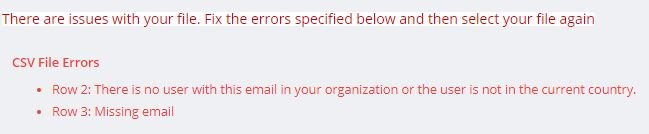

3. In the New Bulk Checkout screen click the Choose File button to select a CSV file containing the users you are checking the licenses out for. There is a link to download a sample and formatting guidelines for this CSV file. The file requires two columns
Once a CSV file is selected, it will be validated, and any errors will be displayed.
Otherwise, a green message will confirm proper formatting.

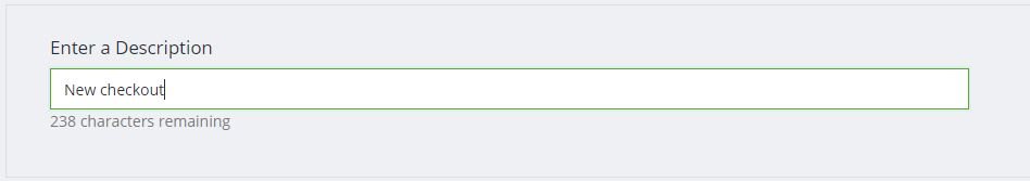

4. Enter a description for the bulk checkout. This is only to help you organize the bulk checkouts within Entitlement Management.

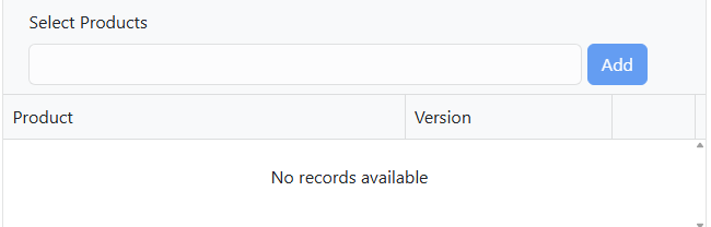

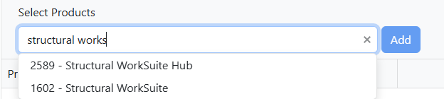

5. Enter the Product name and select it from the drop-down. A checkout may have multiple products. Enter a valid version number for each product.

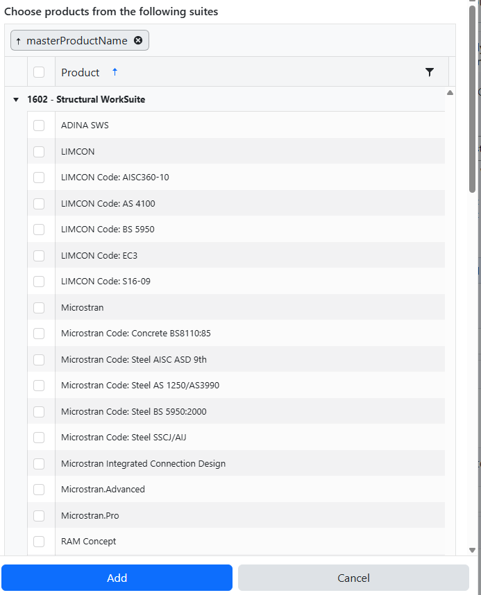

If the license covers child products, such as Structural WorkSuite, you will be prompted to choose a specific product.

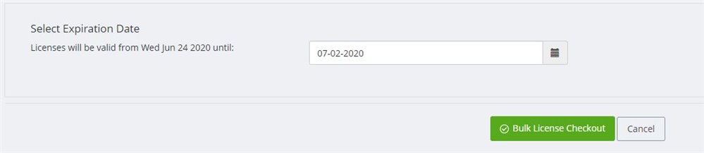

6. Select the expiration date for the checkout. The checkout will automatically expire at this date.

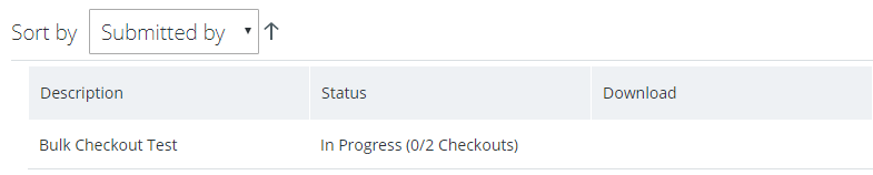

7. Click the green 'Bulk License Checkout' button. At this time, Bentley has begun recording 24/7 usage of the Product until the license has been checked in. The browser will return to the Bulk License Checkout page. The new checkout will be displayed at the top of the list. The Status column will show progress of the checkout process.

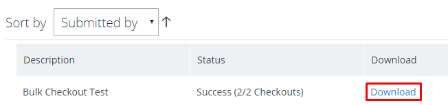

8. Once complete, the Status column will update, and a Download link will appear in the Download column. Click it to download a zip archive containing the license files for all machines
9. Open the zip archive to see a list of license files. Each is encoded with a machine name.

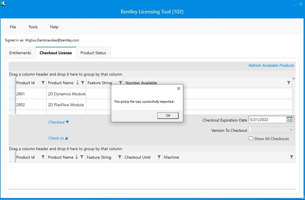

1. Open Bentley Licensing Tool and click "File". You will have the option to import the license file by either File or Folder

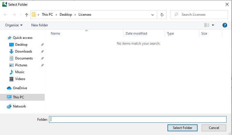

2. Click on "Import Policy Folder". This will open the File Explorer. Locate the folder with the licenses that the administrator checked out in Entitlement Management. Navigate into the folder and then click "Select Folder".
3. The File Explorer window will close and return to the Bentley Licensing Tool. A message will pop up indicating that "The Policy file was successfully imported."

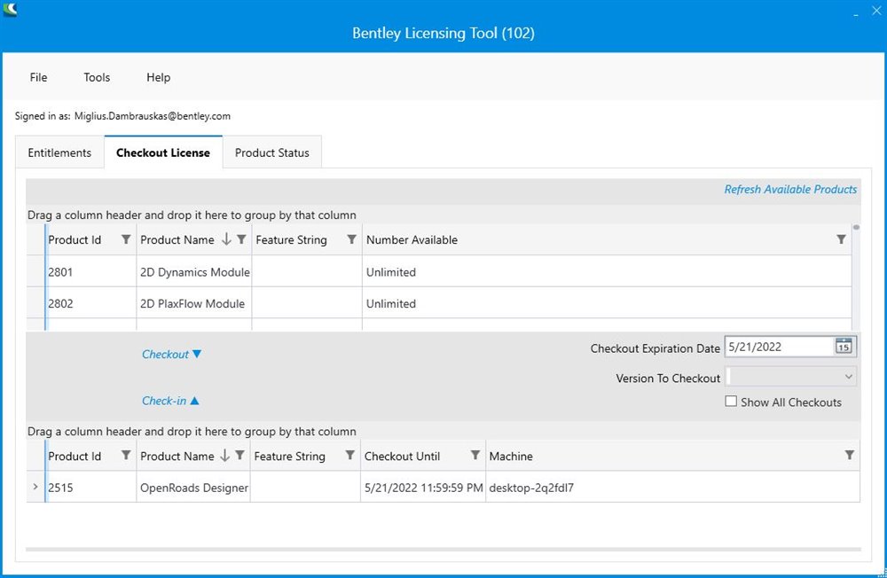

4. The bottom pane of the Checkout Licenses tab shows the active checkouts on your machine.
