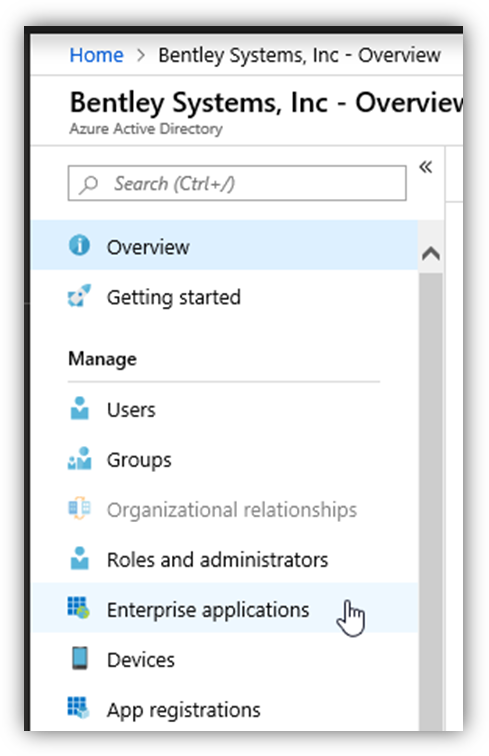

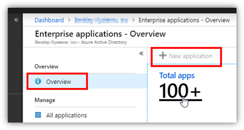

Create the Application in Azure AD
Note: The interface for Azure changed in early 2019, so your Azure interface may look different than the screenshots depicted below.

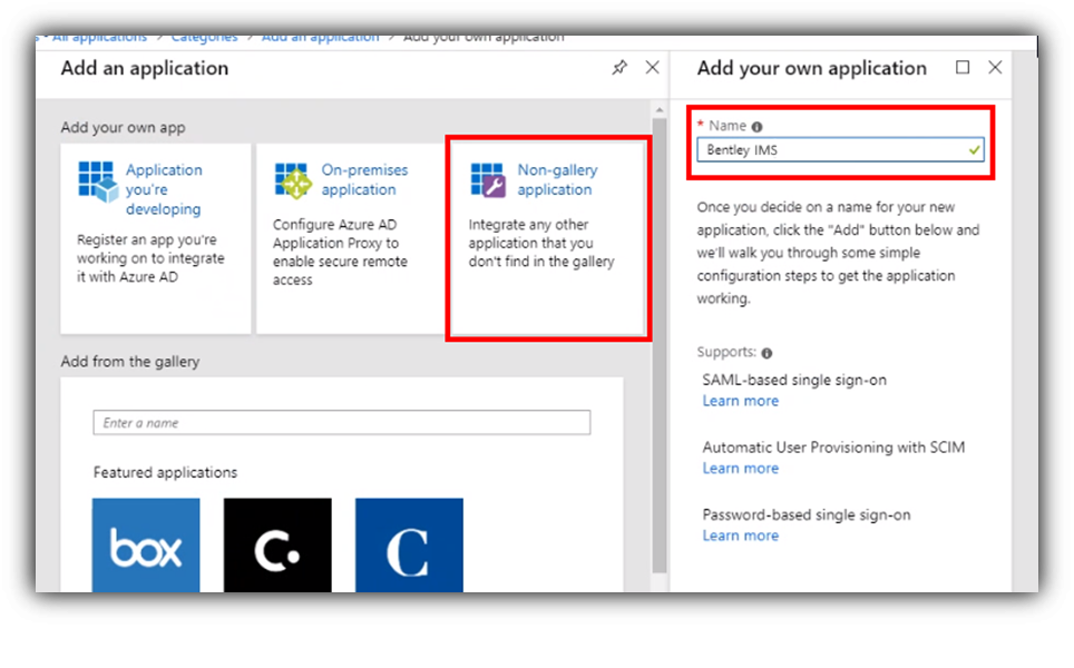

Add an Application

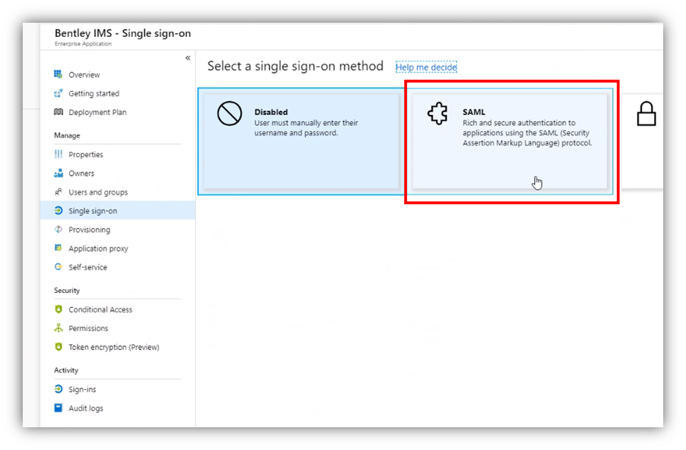

Choose Single Sign-On and SAML:
Choose SAML

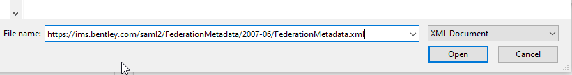

Import Bentley's Federation Metadata
https://ims.bentley.com/saml2/FederationMetadata/2007-06/FederationMetadata.xml

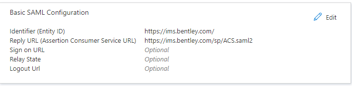

Basic SAML Config
Identifier: https://ims.bentley.com/
Reply URL: https://ims.bentley.com/sp/ACS.saml2

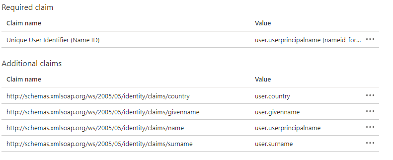

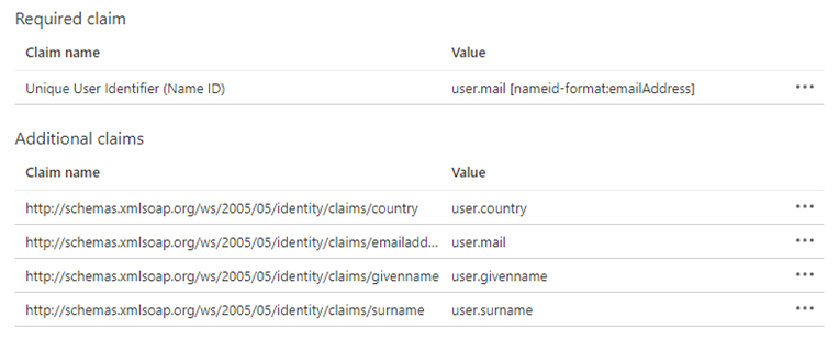

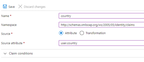

Define the Claims
You will need to add the country claim, which is not included by default.
Note: It is required that a user have a valid country code in your directory in order to federate. We use this information to determine proper entitlements, billing, taxes, and more.
Schema: http://schemas.xmlsoap.org/ws/2005/05/identity/claims
E-Mail:
UPN:

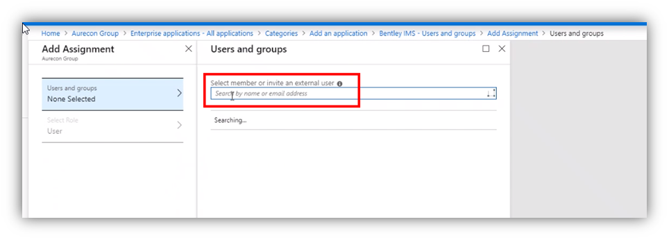

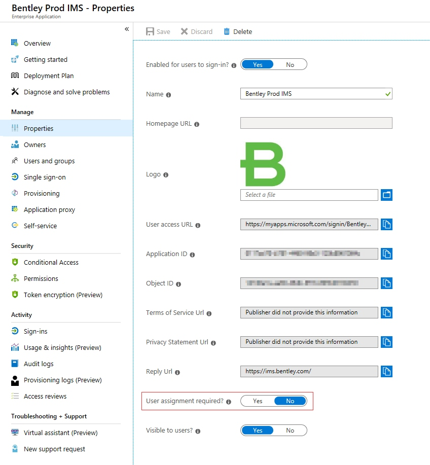

Define the Users and Groups for this application
Users and Groups
Add users individually

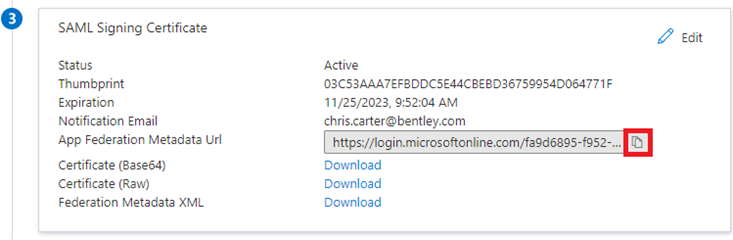

Copy the federation metadata URL and send it to Bentley

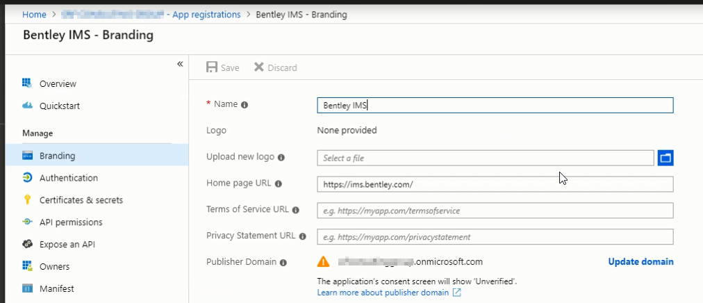

Configure the Branding page (optional)
Branding
OPTIONAL: You may download this Bentley logo image and use it as the application icon:
