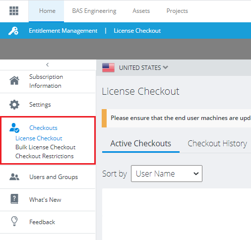

3. On the Entitlement Management site that appears, select License Checkout

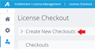

4. On the License Checkout page, click on Create New Checkouts to expand it.
Screenshot showing Create New Checkouts

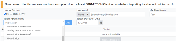

5. In the expanded section, enter the name or email address of a Bentley login associated with your organization. To specify an email address, choose Email from the drop-down menu. In either case, select one of the matches that appear as you type.
*Please note: The user specified need not be the recipient of the license file. We recommend specifying the recipient if he or she has a Bentley login since the name will appear on the Active Checkouts list. Otherwise, specify the administrator generating the license file.
Screenshot of New License Checkout fields
6. If checking out a license for a product using the Subscription Entitlement Service, leave the SES radio button selected. Otherwise, select the SELECTserver radio button instead. Note the fields will change when doing so.
7. In the Machine Name field enter the computer name of the recipient's computer. The computer name can be retrieved from the System control panel.
8. Under the Select Applications section, enter the name of a product. As you type, a list of search results will appear. Choose one from the list. Multiple products can be added if necessary. Then click the Add button.
9. Enter a four-part version number in the Version field for each product listed. This should match the version number of the product on the recipient's computer. It will be recorded on the Active Checkouts list for administrative purposes. By default, Entitlement Management will attempt to check out a license for one year. To specify a duration less than a year, modify the date specified in the Select Expiration Date field by clicking the calendar widget. Once finished, click the green License Checkout button.
