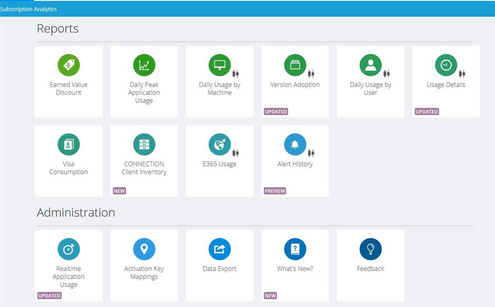

  1. Go to the Subscription Analytics
  2. Click on the Alert History.

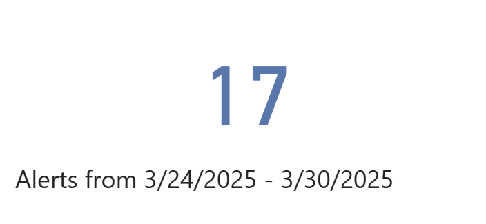

Layout - Alerts from [Date] - [Date]
The number of alerts triggered during the most recent week (Monday - Sunday). The default is the current week. If you use the Date filter to pick a different date range, this visual will show the most recent week in your selected date range.

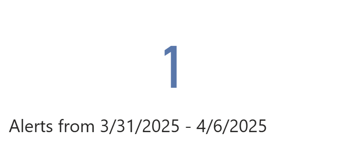

Layout - Alerts from Week Prior to [Date]
The number of alerts triggered during the second most recent week (Monday - Sunday). The default is the previous week. If you use the Date filter to pick a different date range, this visual will show the second most recent week in your selected date range.

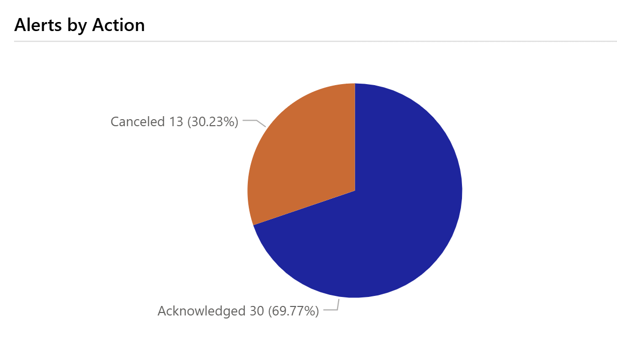

Layout - Alerts
This pie chart shows how many of the alerts that have been triggered were Acknowledged or Canceled.

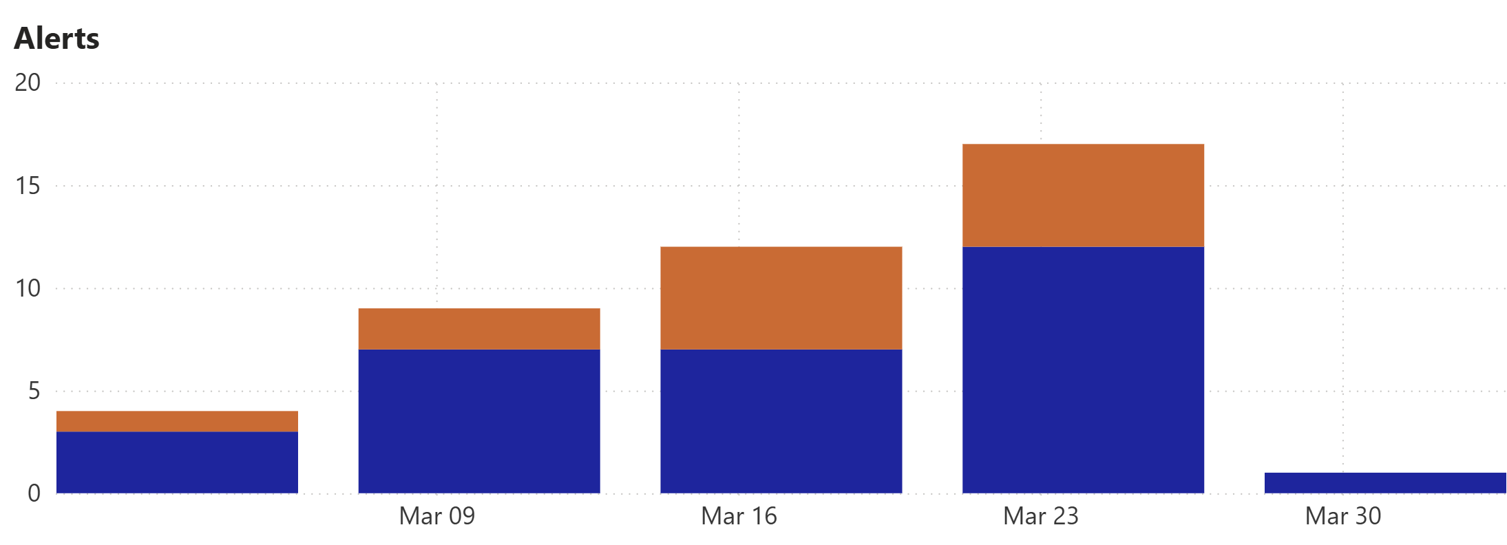

Layout - Custom Chart
This stacked bar graph allows you to select the dimensions for your X-axis and for your stacks.
Name
Description
Usage Date
The date of the alert. This is the default X axis.
Action
If the user Acknowledged or Canceled the alert. This is the default stack
Application
Product and Feature String
Email
IMS user's email address
Country
User's Entitlement Country
Start of Week
The date when each week starts
Machine
Machine Name

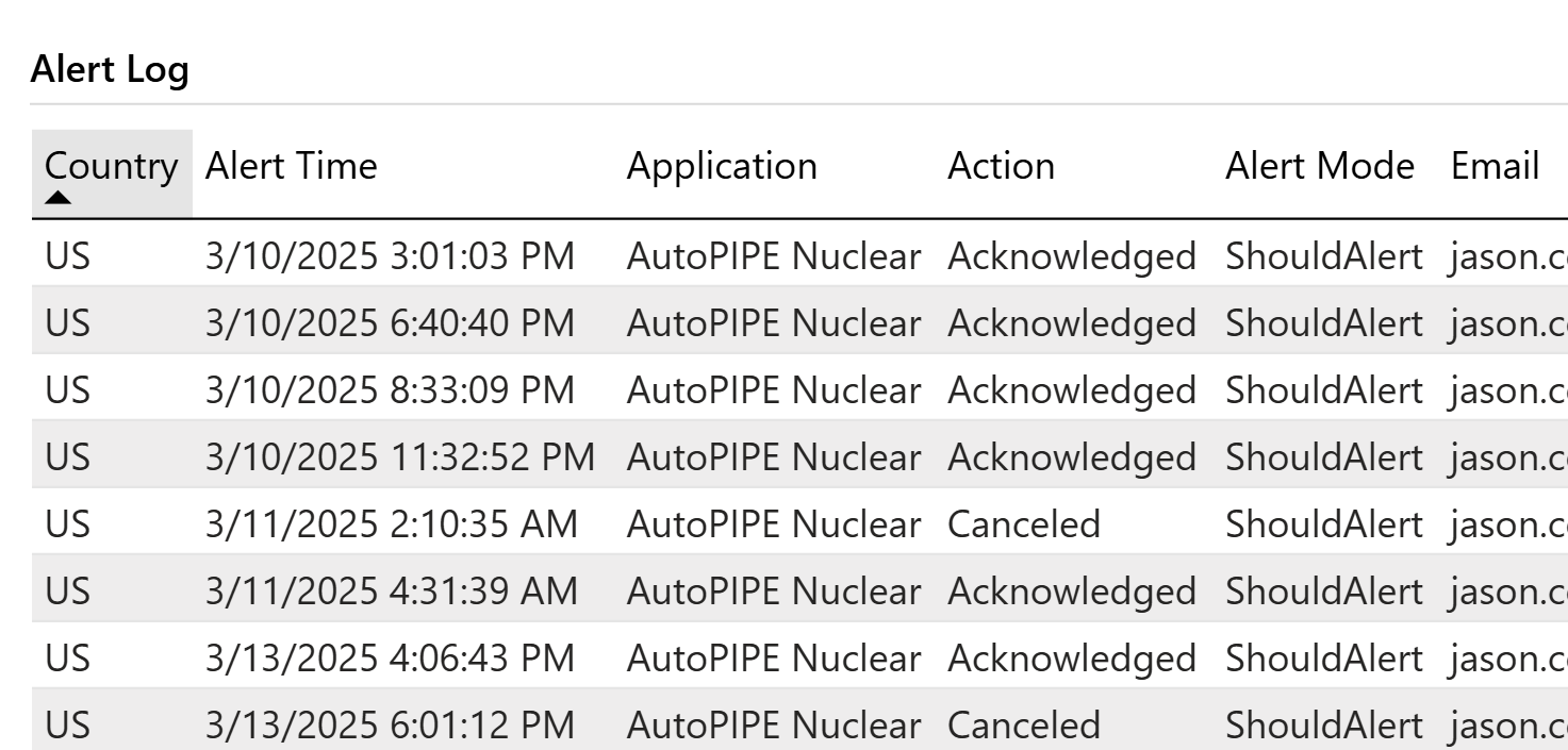

Layout - Alert Log
A detailed log of the alerts that have been triggered and exactly when they were triggered.
Name
Description
Country
Alert Time
The exact UTC time that the alert was triggered
Application
Action
If the user Acknowledged or Canceled the threshold alert;
Offline Blocked - a user was offline and tried using an application which is Offline disallowed( in Entitlement/License Management).
Alert Mode
The alert mode. Most alert modes are ShouldAlert
Email
User
Windows NT user name
Machine
Machine name
Alerts
Number of alerts that were issued. This column is most useful if the results are exported
Alert Threshold
The threshold of licenses for an application in use before an alert was triggered as configured at the time of the alert in Entitlement Management
Licenses in Use at Alert
The number of online SES licenses that were in use when the alert was triggered
