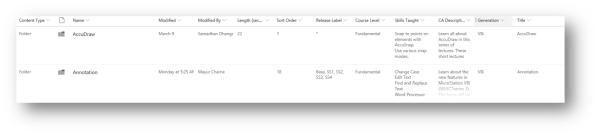

  11. CONNECTION Client is showing zero content for In House Content. Please check the SharePoint site for any issues. Contact your SharePoint administrator. Some of the troubleshooting techniques are mentioned below.
a. Check metadata information. All the fields should be populated with the required values. Title, Description, Release Label, Generation is a must.
b. There shouldn’t be any duplicate items in the list. At least, Title and Description should be uncommon between those items.

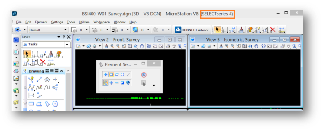

c. Check release label added in SharePoint against the product from where the CONNECTION Client is being launched. For e.g.: I have MicroStation SS4 installed and on SharePoint Release Label field also contains SS4, so no issues.

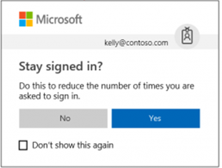

How to Re-enable “Keep Me Signed In” Window:
Situation:
Users who have already set their preference in the “Keep Me Signed In” window and have checked the “Don’t Ask Me Again” box, are not able to change this preference. Now they are asked to sign into SharePoint every time they access CAPS.
To enable persistent cookie in SharePoint through Admin:
https://techcommunity.microsoft.com/t5/sharepoint-support-blog/cookie-persistence-in-sharepoint-online/ba-p/847724
ADFS Administrators can add or edit their issuance claims rules for the Microsoft Office 365 Identity Platform relying on party trust to include the PSSO claim
