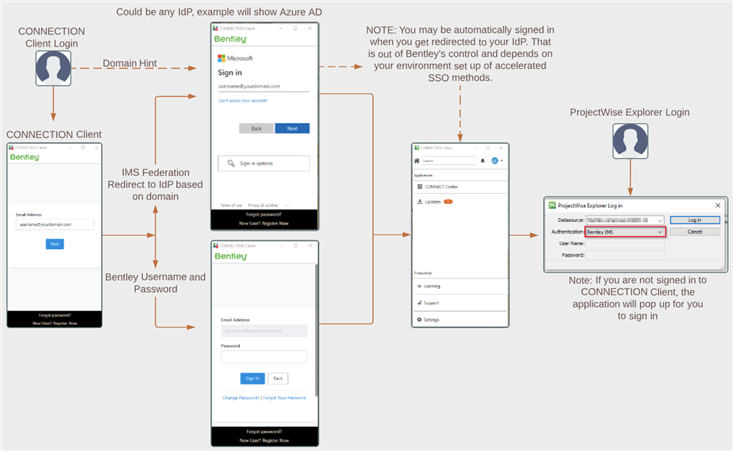

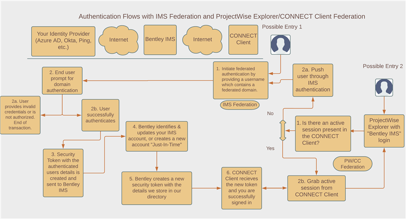

What are the differences between ProjectWise/CONNECTION Client federation and IMS/Identity Provider federation?
The connection between ProjectWise and CONNECTION Client simply allows for you to sign into your IMS-enabled ProjectWise Datasource with the same IMS account that you've already signed into the CONNECTION Client with. However, ProjectWise does not know what type of authentication you performed to access the CONNECTION Client - whether federated or native authentication with Bentley username and password. It simply reuses the session from the CONNECTION Client to sign you in.
The connection between IMS and your IdP allows for you to sign into the CONNECTION Client with your work/domain credentials. This signs you into your IMS account which is then passed into the Service Provider, such as CONNECTION Client. CONNECTION Client then acts as an Identity Provider to applications like ProjectWise and shares the details of the authenticated user to get them signed into the applications downstream from CONNECTION Client.
Here's are a couple images to illustrate the flow:
