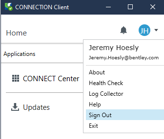

  2. Select "Sign Out" from the drop-down menu in the upper right.
    Screenshot of sign out

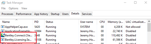

  4. Open Task Manager, and end tasks for Bentley.Licensing.Common for Windows (or Bentley.Licensing.Service.exe for earlier versions of CONNECTION CLient) and Bentley.Connect.Client.exe in that order. As an alternative, restart the machine.
    Screenshot of Task Manager

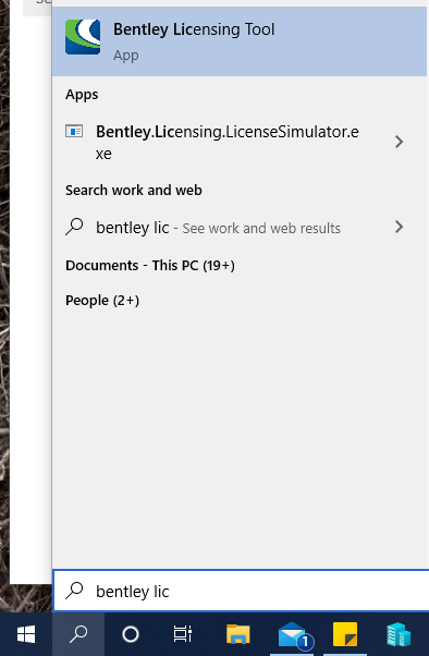

  5. Open the Windows Start menu, and do a search for Bentley Licensing Tool (alternatively, open Bentley Licensing Tool using any of the methods described here).
    Screenshot of Windows Start menu search
