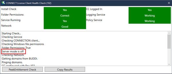

Some server-based products such as ProjectWise InterPlot Server utilize a special server mode for licensing which uses a SYSTEM instance of Bentley.Licensing.Service.exe. To check whether Server Mode is active, perform the following steps:
  1. Search the Windows Start menu for Bentley Health Check Tool.
  2. Run the health check, and note in the text box whether server mode is on.
    Screenshot highlighting server mode designation
  3. If on and you are not running a server-based product, refer to the following instructions for turning server mode off.
