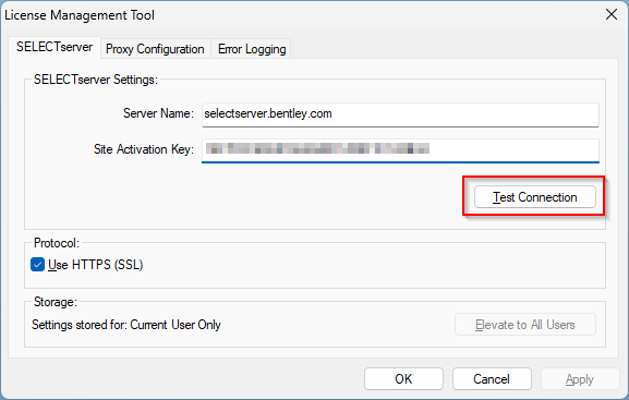

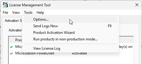

1. From the client workstation where the software is installed, open the License Management Tool.
From within the License Management Tool, go to the "Tools" menu and select "Options."
Confirm the server name:
- SELECTserver Online: selectserver.bentley.com -- Make sure Bentley has two e's!
- Deployed SELECTserver: In most cases, the server name should match the hostname for the server where SELECTserver is installed on your network. Check with your site administrator to make sure you're using the correct server name.
Confirm the site activation key:
- Given the length of the site activation key, we recommend copying and pasting the site activation key.
- Make sure there are no leading or trailing spaces. Copying and pasting sometimes results in an extra space at the end.
- The site activation key is case sensitive. All letters should be CAPITALIZED.
- Anything which looks like an 'O' is a zero (0). Our keys do not use the letter O.
Click "Test Connection". You should get a message stating “SELECT Server and Activation key verified.
You could also get the following messages:
- “An error has occurred while attempting to verify the server and activation key” -- This means the server specified could not be reached.
- Try enabling the “Use HTTPS (SSL)” setting. Your network may require it.
- There may be a firewall or proxy server preventing communication with the server. Review our information on connecting to Bentley servers through firewall or proxy servers.
- See the next step for information on verifying your connection to your SELECTserver.
- “Server does not support this activation key.” -- This means a connection to the server specified was able to be made, but the Site Activation Key is incorrect.
- Return to the previous step to confirm Server Name and Site Activation Key.

4. From within the License Management Tool, go to the "Tools" menu and select "Send Logs Now." This forces the workstation to re-establish connection with the server. Repeat up to three times.
