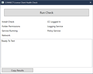

  3. Click the Run Check button.
    Screenshot of Health Check window
  4. Note whether any tests fail, specifically the Service Running test.
