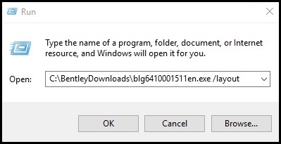

1. In the command line, go to the folder that contains the CONNECTION Client setup executable and run the executable with the /layout command.

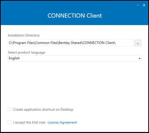

2. The CONNECTION Client Installation Wizard opens.

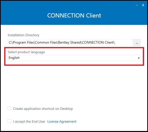

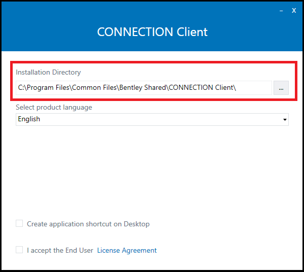

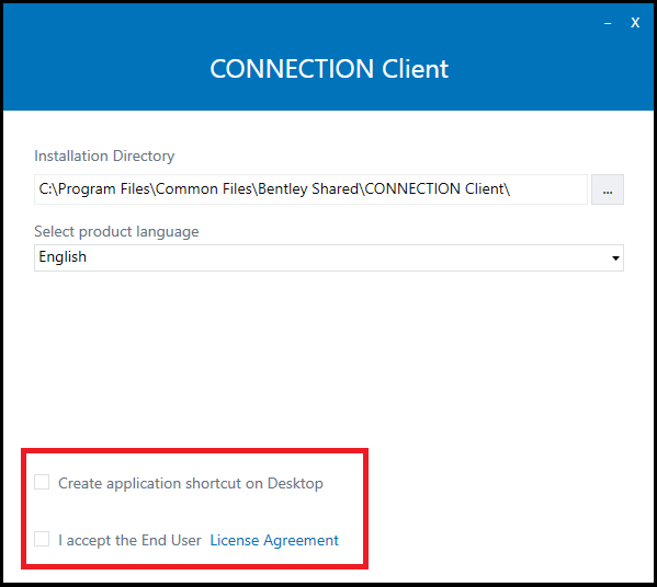

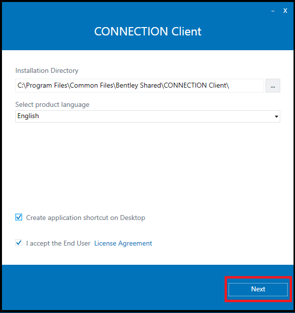

3. (Optional) To change the application installation location, click the Browse button next to the Application Path. We recommend that you accept the default install location unless there is a particular reason not to: In the Browse For Folder dialog that opens, browse to the drive and folder you want to install the product in, then click OK.
4. Select the language version to be installed
5. [optional] Create application shortcut on Desktop
    [Required] Accept the End User License Agreement
6. Click Next

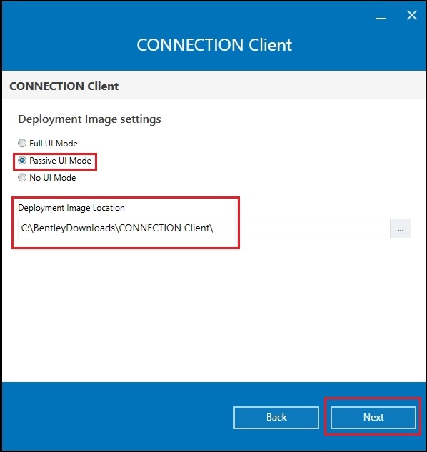

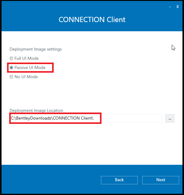

7. Select the installation mode, 'Passive UI Mode' is the default that applies to most situations. Browse to and select the Deployment Image Location, creating a separate sub-folder for each deployment image

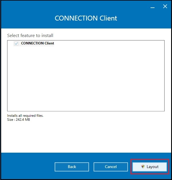

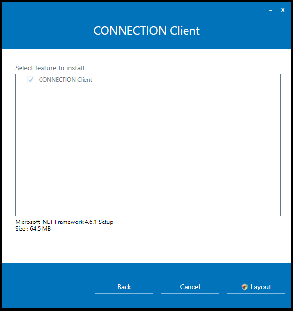

8. In the Features stage the only feature installed is the CONNECTION Client

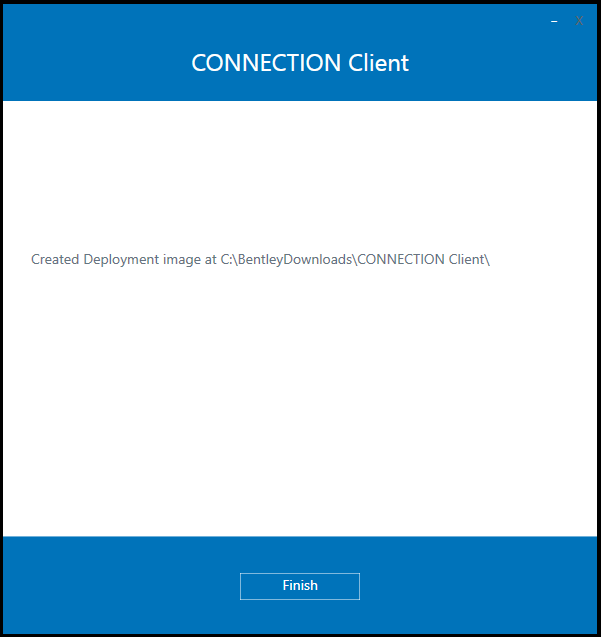

9. Click Layout to create the deployment image. The usual installer dialog boxes will appear, and required (or potentially required) components will be downloaded
10. Click Finish to exit the CONNECTION Client Installation Wizard. The deployment image is created at the selected location.

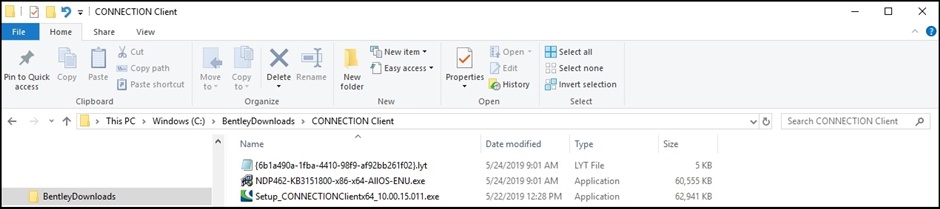

The resulting files created will be similar to this:
*Please note: These files are included in the deployment image so that all required files are available on the local network during installation without the need for further online downloads speeding up the installation and avoiding repeated downloads of the same files.
