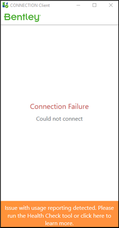

At the start of the CONNECTION Client it says "Connection Failure - Could not connect"
 Screenshot of Connection Failure in CONNECTION Client

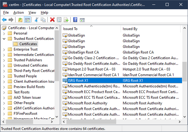

The following error shows that the user does not have the ISRG Root X1 security certificate installed:
ERROR - BUDDIClient - GetUrl() encountered an error: System.ServiceModel.Security.SecurityNegotiationException: Could not establish trust relationship for the SSL/TLS secure channel with authority 'buddi.bentley.com'. ---> System.Net.WebException: The underlying connection was closed: Could not establish trust relationship for the SSL/TLS secure channel. ---> System.Security.Authentication.AuthenticationException: The remote certificate is invalid according to the validation procedure.
Explanation
Several Bentley servers utilize a security certificate signed by Let's Encrypt. Let's Encrypt certificates are signed by R3 which in turn is signed by ISRG Root X1 as described in the following explanation from Let's Encrypt. If ISRG Root X1 is not trusted, some of our security certificates will not be either. Following is an explanation for the transition to ISRG Root since Let's Encrypt was previously signed by a different root certificate authority.
Have IT confirm ISRG Root X1 is listed in the Trusted Root Certification Authorities list in the Certificate snap-in for Microsoft Management Console.
Screenshot of Trusted Root Certification Authorities
NOTE:
We do not provide the certificate and if it is missing your internal IT department needs to obtained it from the Certificate Authority - navigate to the CONNECT Center, click the padlock icon to the left of the URL, select "Connection is secure" and click the certificate information/icon - the certificate details will be displayed, click the "Issuer Statement" button, which will direct you to the Let's Encrypt Certificate Authority.
