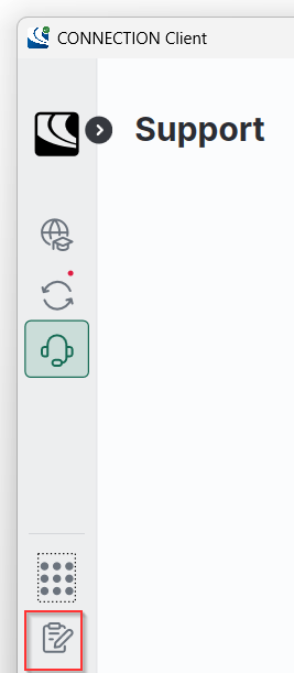

From CONNECTION Client, open the Bentley License Tool (Clipboard Icon) -

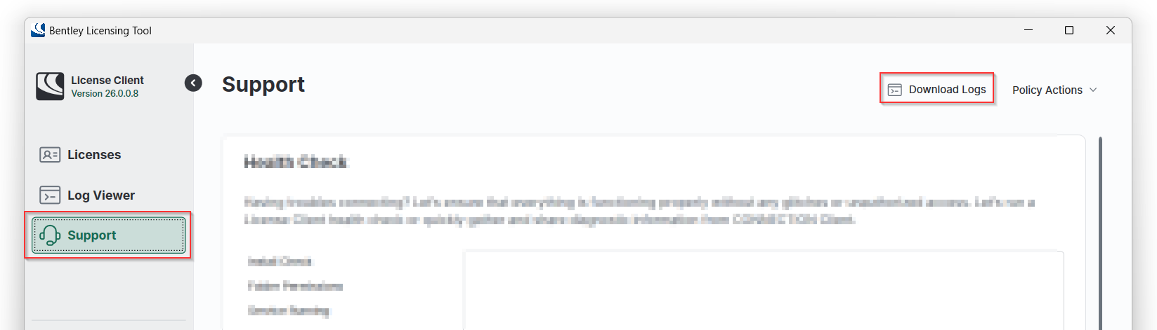

Click on "Support", then "Download Logs" -

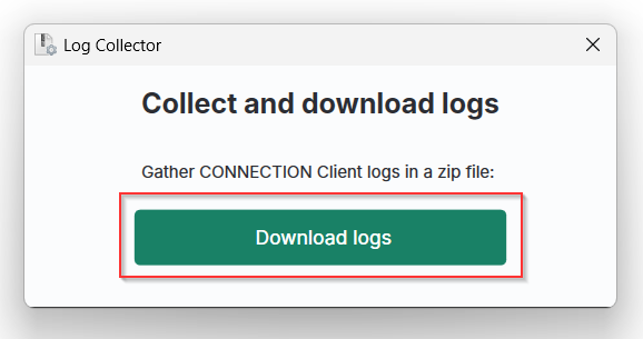

Click "Download Logs" on the popup window that appears -
Please name resulting zip file with Date and Case # in the "Save Log Files" dialog.

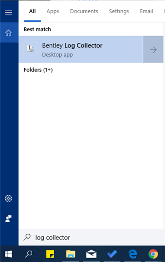

Option 1:
Open the Windows Start menu, type Log Collector, and choose Bentley Log Collector from the search results.

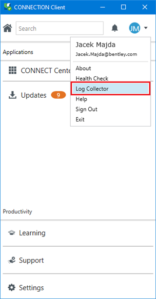

Option 2:
  1. Open CONNECTION Client (either open Windows Start menu, type CONNECTION Client, and choose CONNECTION Client from the search results, or right-click the CONNECTION Client icon in the Windows task bar and select Open).
  2. Click the drop-down arrow next to your initials icon in the upper right corner and select Log Collector from the drop-down list.
Log Collector option available in the drop-down list in the CONNECTION Client
