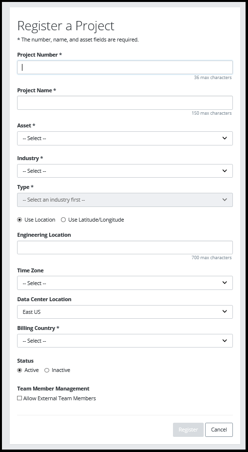

How to register a ProjectWise Project?

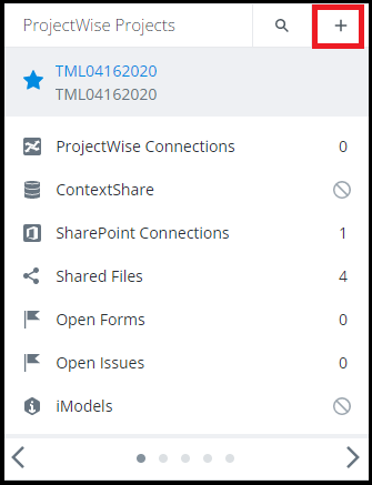

1. From the CONNECTION Client click the CONNECT Center link or from your internet browser go to the CONNECT Center
2. On the ProjectWise Projects Tile, select + in the upper right corner (if you do not have the + symbol that means you don't have the proper role to register a project. You will have to contact your account administrator to request one of the roles mentioned in the "Who can register a CONNECTED Project" section above).

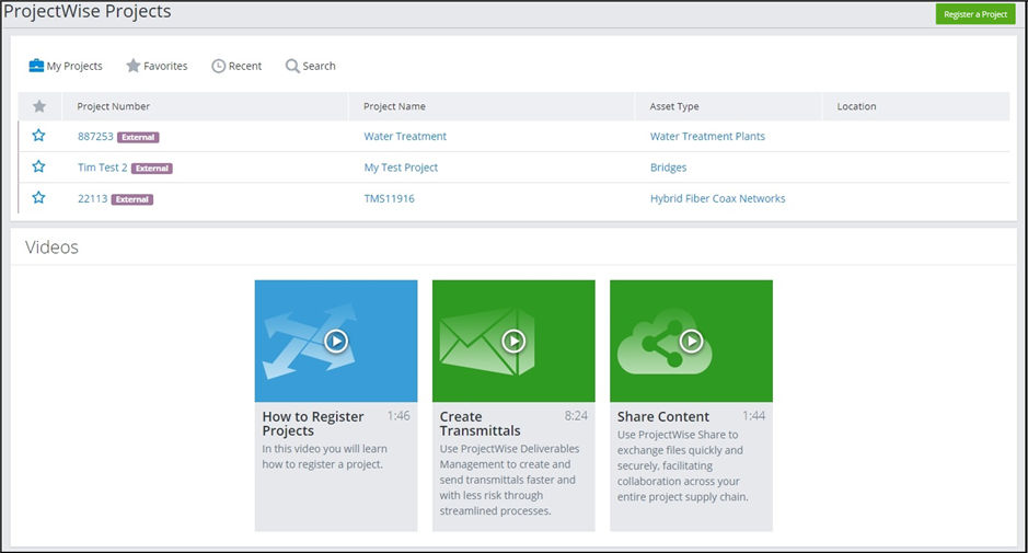

Or, from the main menu select Projects
3. Then click the green button Register a Project
4. Registration dialog box will be displayed.
 5. Below is a brief description of each field:
6. When all fields are defined click the Save button.
7. After saving you will be taken to the ProjectWise Portal of your newly created project.

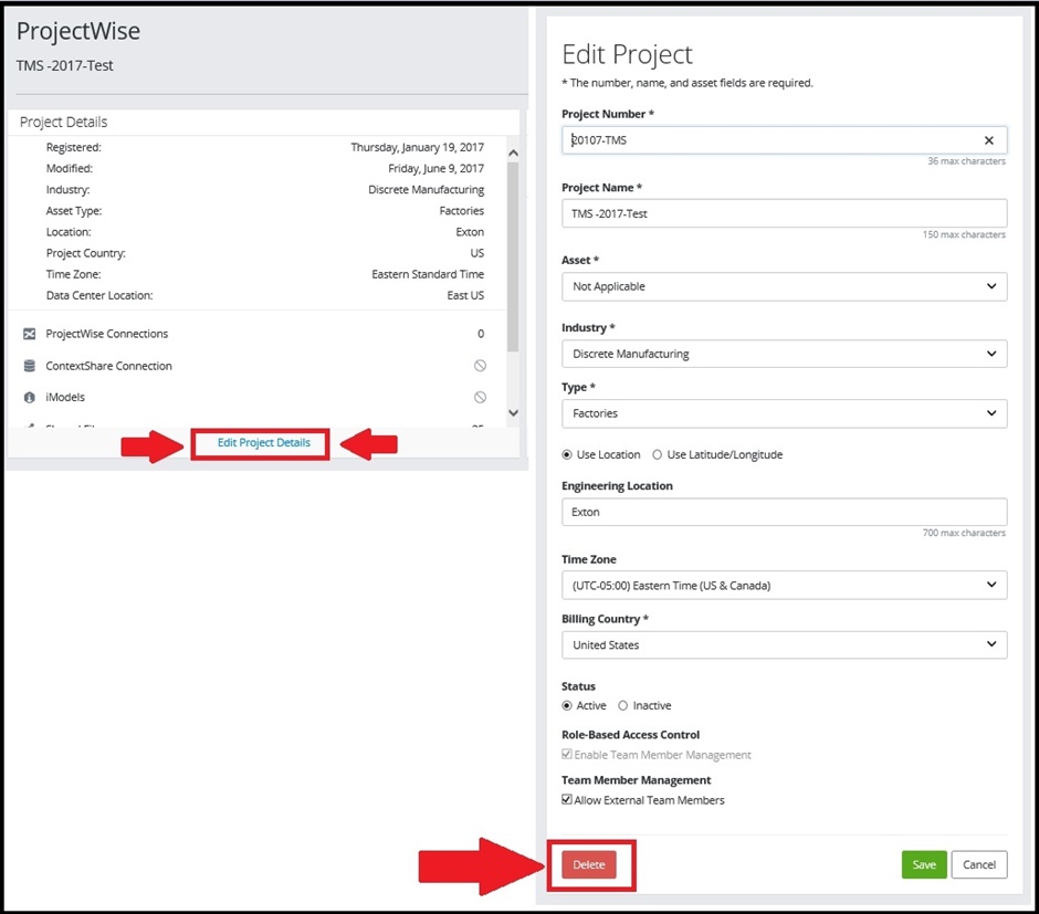

How to Delete an Existing ProjectWise Project?
1. Select the ProjectWise Project that you wish to delete
2. Click Edit Project Details
3. Click Delete
***Please Note: If you delete a ProjectWise Project that has had any of the services enabled, you will no longer have access to the data of that service. Please carefully consider this before deleting a ProjectWise Project.***
