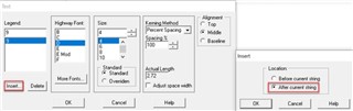

1) Right click on the existing legend and pick Edit Data from the floating menu.
2) In the Text dialog box, press the Insert button. In the Insert dialog, pick Location: After current string and press OK.

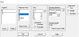

3) In the Legend box, press <spacebar> to insert a space and change the Size to 1.2

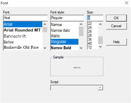

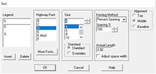

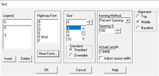

4) Press the Insert button, pick Location: After current string and press OK. In the Legend box, press <shift>% to add the percent symbol. Change the size: 4 and press the More Fonts button.
5) In the Font dialog, select the desired font, font style and size. Press OK.
6) Press OK to the Text dialog.
