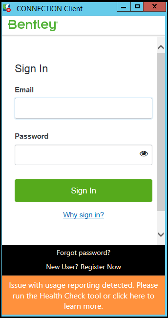

The following message appears when the CONNECTION Client is started:
Issue with usage reporting detected. Please run the Health Check tool or click here to learn more
