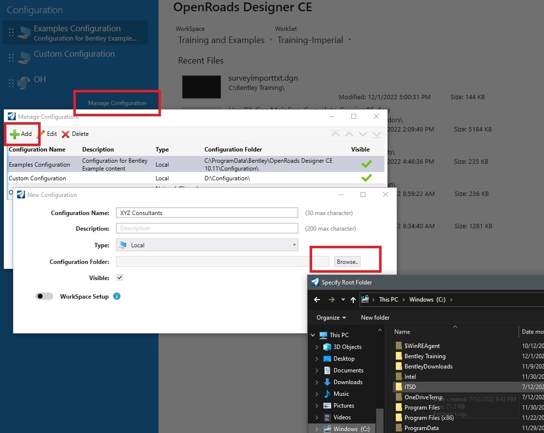

Note: Beginning in the 10.11.00.115 release, instead of editing the "ConfigurationSetup.cfg" file to point to the Custom Configuration location as shown in the video above on version 10.10, the user can use the Manage Configuration command on the startup page to set the location of their custom configuration.
