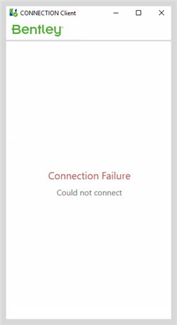

Otherwise, a "Connection Failure" message displays but never completes.
 Screenshot of Connection Failure in CONNECTION Client

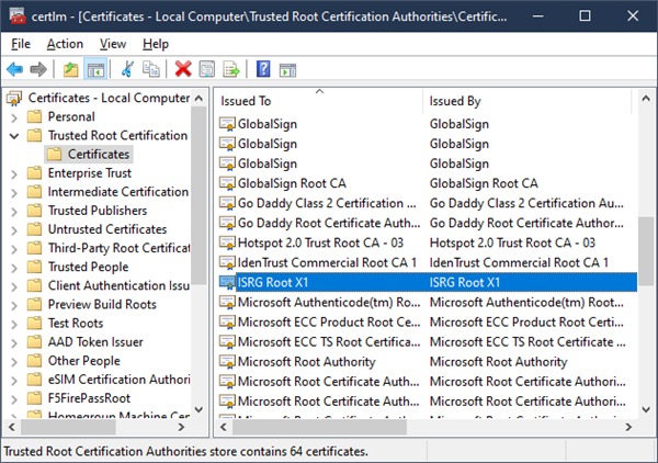

Several Bentley servers utilize a security certificate signed by Let's Encrypt. Let's Encrypt certificates are signed by R3 which in turn is signed by ISRG Root X1 as described in the following explanation from Let's Encrypt. If ISRG Root X1 is not trusted, some of our security certificates will not be either. Following is an explanation for the transition to ISRG Root since Let's Encrypt was previously signed by a different root certificate authority.
How to Avoid
Have IT confirm ISRG Root X1 is listed in the Trusted Root Certification Authorities list in the Certificate snap-in for Microsoft Management Console.
 To access Certificate Manager, click the Start button, type certmgr.msc in the search field, and click the Enter key.
Screenshot of Trusted Root Certification Authorities
