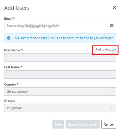

The administrator or co-administrator can get the message "This user already exists. Click 'Add to account' to add to your account" while registering the user in User Management.
This situation can occur when the user is unaffiliated - in scenarios, where:
- The user registered their profile on the Bentley site with an email of the company's domain, however, the company's account does not have the automatic approval option turned on for the domains they own.
- The user registered their profile with a generally available email address, such as Gmail, Outlook, Yahoo, etc.
- The user was removed from his/her organisation by an account administrator - this locked the user automatically for security purposes.
NOTE:
For more information about user management, see: Managing Users
Click the "Add to Account" hyperlink in the modal window to finish adding the user, as shown in the above screenshot.
