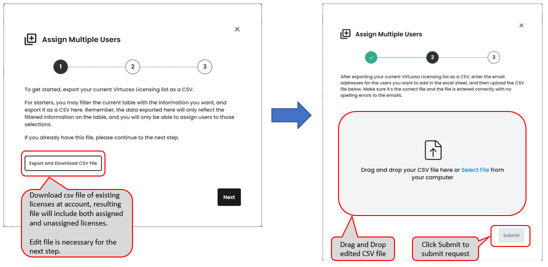

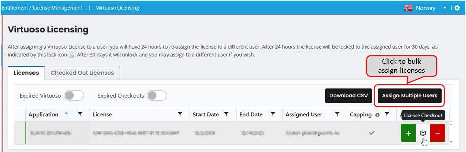

How can I bulk assign Virtuoso Licenses?
The functionality of bulk assigning Virtuoso licenses is useful when licenses are many and assigning them one by one becomes a time consuming and error-prone task. Use it when assigning the licenses for the first time and after renewal (see workflows below). We recommend exporting the current assignments to use it as a template later.
This functionality is available for Admins or Co-Admins in Practitioner page in Entitlement Management via the “Assign Multiple Users” action. Downloading a .csv file with virtuoso licenses is available under this action or as a separate one (“Download CSV” button).
Possible workflows:
1. Assign Virtuoso licenses for the first time:
  1. Export data with unassigned Virtuoso licenses to .csv file.
  2. Assign (fill in “Assign User” field with the user email) unassigned Virtuoso licenses. Do not change any other data.
  3. Import the .csv file and observe the result (successful import/updated information in Practitioner page or the list of errors/information not updated in Practitioner page)
2. Renewal (based on template):
  1. Export data with assigned Virtuoso licenses to .csv file. Keep it as a template.
  2. Export data with unassigned Virtuoso licenses to .csv file.
  3. Assign (fill in “Assign User” field with the user email) unassigned Virtuoso licenses based on “Assign User” field data of template. Do not change any other data.
  4. Import the .csv file and observe the result (successful import/updated information in Practitioner page or the list of errors/information not updated in Practitioner page)
3. Renewal (based on expired licenses):
  1. Set filter to Expired Virtuoso in Practitioner page
  2. Export data with all Virtuoso licenses (expired+active licenses) to .csv file
  3. Assign (fill in “Assign User” field with the user email) unassigned Virtuoso licenses based on “Assign User” field data of expired licenses. Do not change any other data in active and expired licenses in .csv file
Once the Virtuoso licenses get bulk assigned, users will get email notifications, like in individual license assignment process.

A Practitioner License can be re-assigned as many times as necessary on the first day it is assigned to a user. If it was initially assigned to the incorrect user, then changing it within that first day will require no special action.
After that initial 24-hour assignment period, the Practitioner License will be locked for 30 days. At the end of that 30-day period, the Practitioner License will be available for re-assignment, if necessary. Any re-assignment will start the 24-hour open user assignment period again, followed by a 30-day lock.
The reassignment availability date can be seen by hovering over the disabled (grey) assign ('+') button
