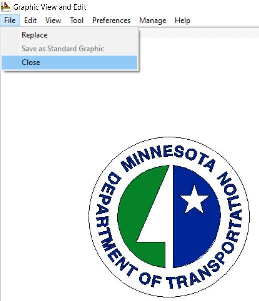

Below are the steps to resize a graphic in OpenRoads SignCAD:

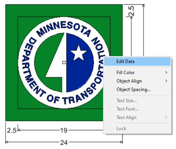

1. Right click on the graphic and pick Edit Data from the floating menu.

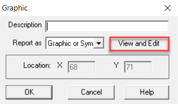

2.  In the Graphic dialog box, press the View and Edit button.

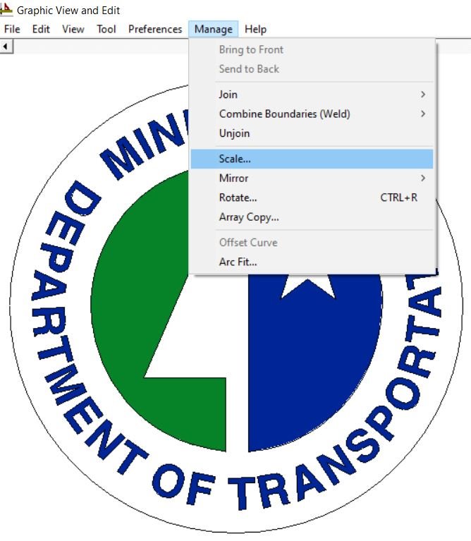

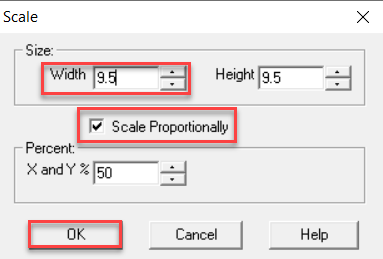

3. In the Graphic View and Edit window, pick Manage>Scale. Set the Width or Height value and the other dimension will automatically adjust if the Scale Proportionally box is checked. Press OK.

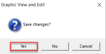

4. Pick File>Close and "Yes" to save changes.

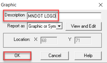

5. In the Graphic dialog box, add a Description if desired and press OK.
6. Save the file (File>Save).
