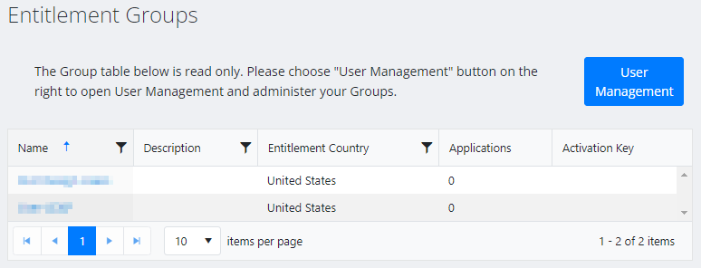

3) In left navigation menu under Users and Groups icon select Allowed Access Group https://connect-entitlementmanagement.bentley.com/entitlement/groups
4) Select The entitlement group (if no groups appear, then they have not been created - Entitlement Groups are created under User Management)

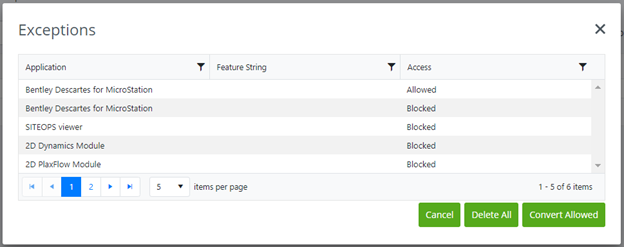

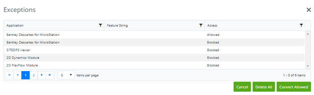

5) Click on a convert button
6) A dialog opens and shows all group level exceptions that were created for this Entitlement Group.

  3. In left navigation menu under Users and Groups icon select Allowed Access Group https://connect-entitlementmanagement.bentley.com/entitlement/groups
  4. Select the group that you want to convert
  5. Click on a convert button
  1. A dialog opens and shows all group level exceptions that were created for this Entitlement Group. You can select to Convert Allowed This converts the group to Allowed Access group. All access blocking exceptions are deleted.
You can delete all previously set exceptions. This will enable entitlement group’s users access to ALL applications until an application is added to Allowed Applications list.
