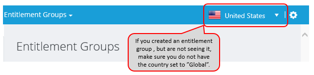

3) In the left navigation menu under the Users and Groups icon select Allowed Access Group https://connect-entitlementmanagement.bentley.com/entitlement/groups

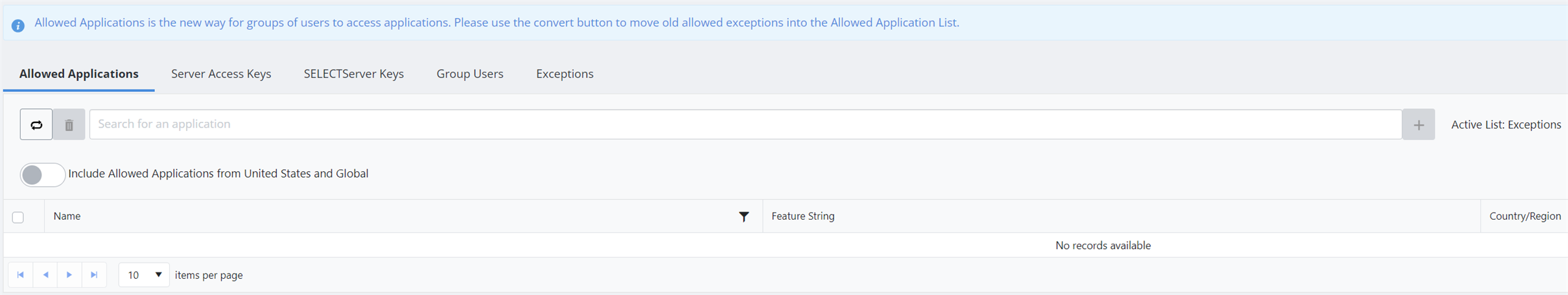

4) Click on a previously created Entitlement group name and you will see the following:

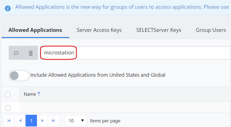

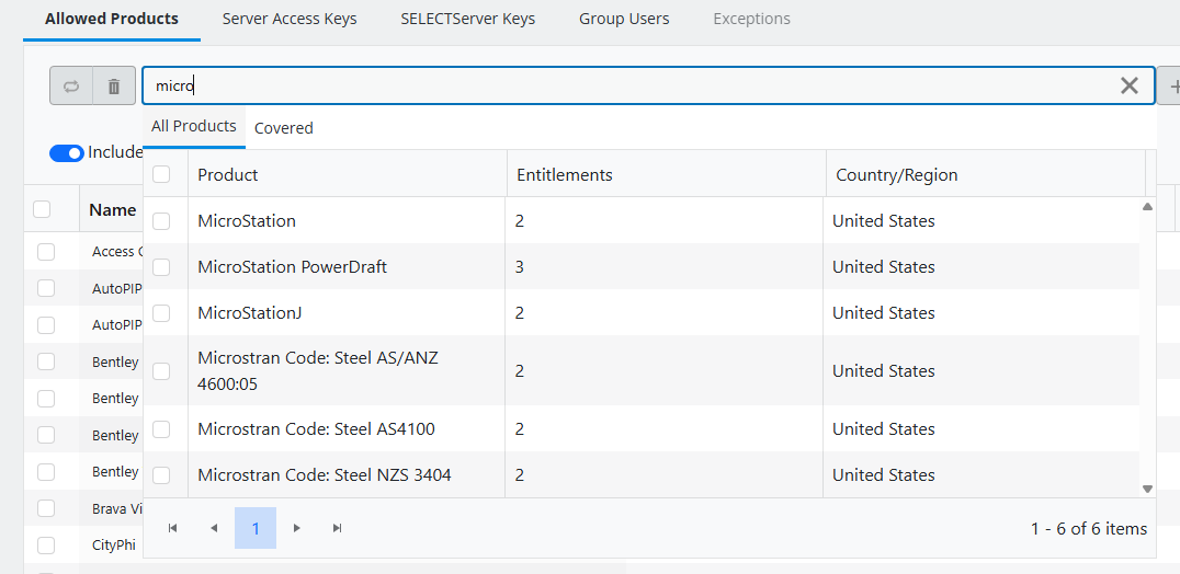

5) Start typing in the product search and a dropdown will appear:

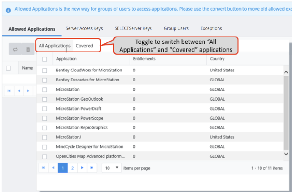

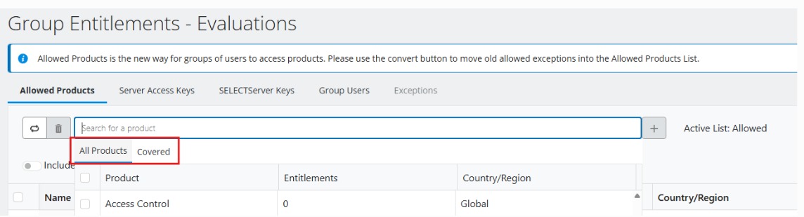

  6 )  Select the Allowed Products tab, click on the Search field - there is a toggle to switch between 'All products' and 'Covered' products.

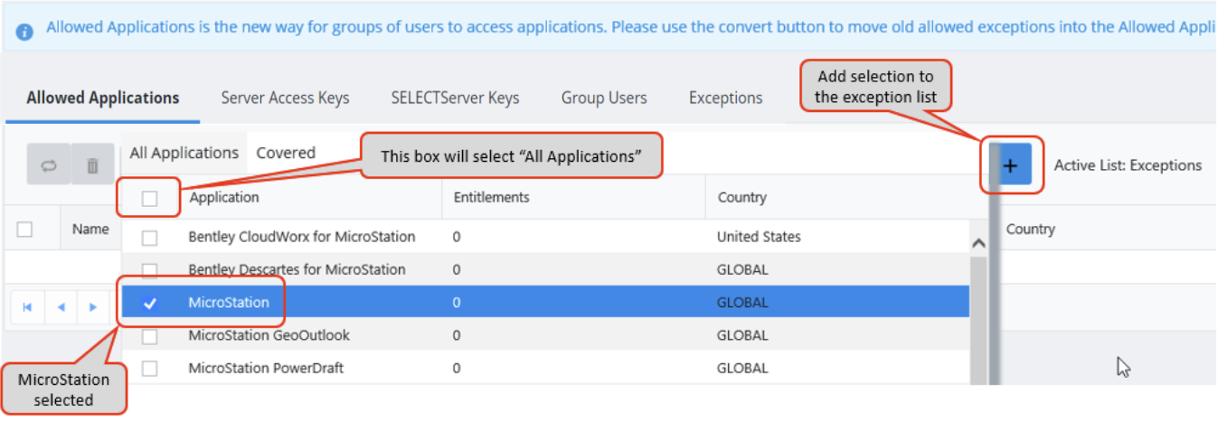

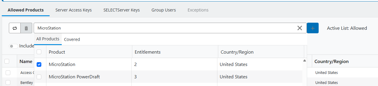

7) In the Search field search for an product that you want this group to HAVE access to. Select the product and click on a blue plus sign:

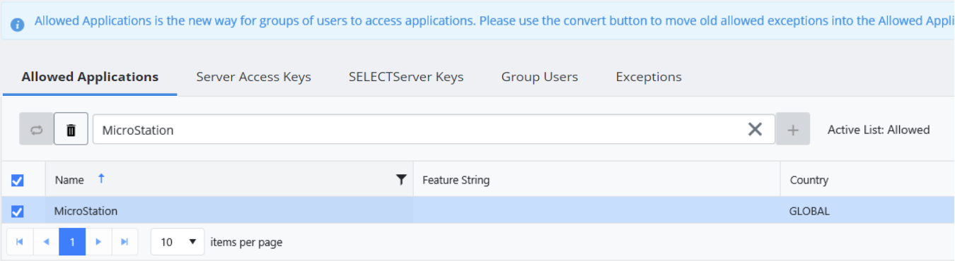

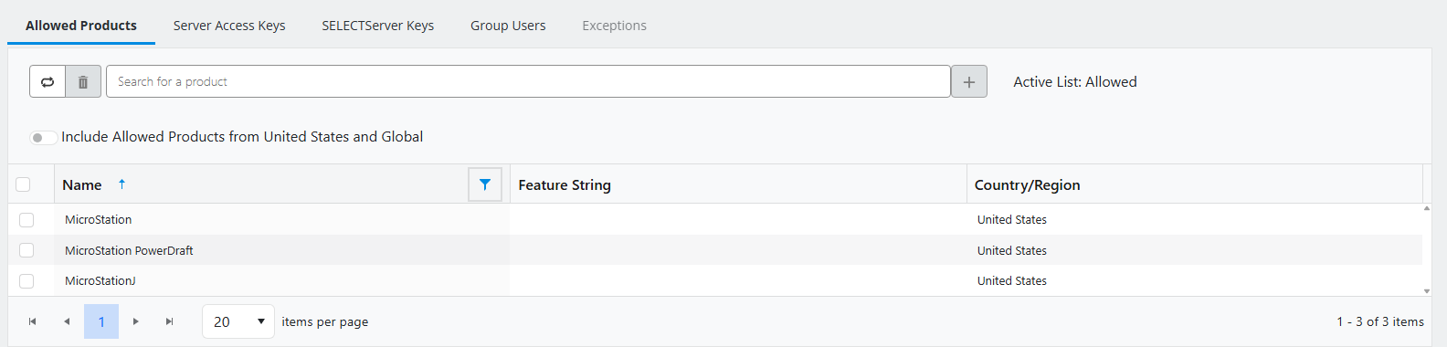

8) Selected product appears on the list. You can repeat this to add many products in one go:
 9) Leave the option to Include Allowed products from the entitlement country turned off.
NB If this option is left off please note that the Entitlement group will only allow access to the Products added to that Entitlement group and no other products.
10) Once the group has at least one product in the Allowed Products list, all other products are blocked for Activation Keys and Group Users associated with this group.

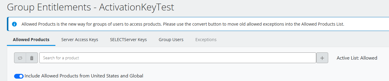

How to extend a user's entitlements to include the Entitlement country entitlements plus the group's list Allowed Products
Follow the same steps to How to add Allowed Products to restrict users in a group to a strict list of entitlements, but enable the option to Include Allowed Products from the Entitlement country.
Turning on this option will provide the users in the group all of the ALLOWED entitlements (Products with default access "Denied" will not be included) from their Entitlements country plus any of the Allowed Products explicitly added to the group.  Allowed Products added to the group will override any "Denied" access settings for the products that might have been set at the Header or Product level.
This is a good way to limit who can access certain products as they can be Denied for everyone else in the organization by using the Product-level or Default-level access controls and Allowed (by adding to the Allowed Product list) only for the users in a particular Entitlement group.
