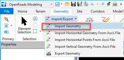

To import this data, use the Import Geometry command. In OpenRoads Designer, the tool can be found under the OpenRoads Modeling Workflow>Geometry Tab>General Tools>Import/Export

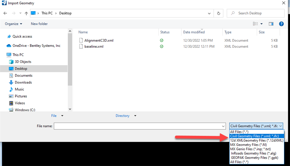

After invoking the command, navigate to the directory where the xml is stored and select it. We can also filter by file type in the lower right corner of the dialogue box.
